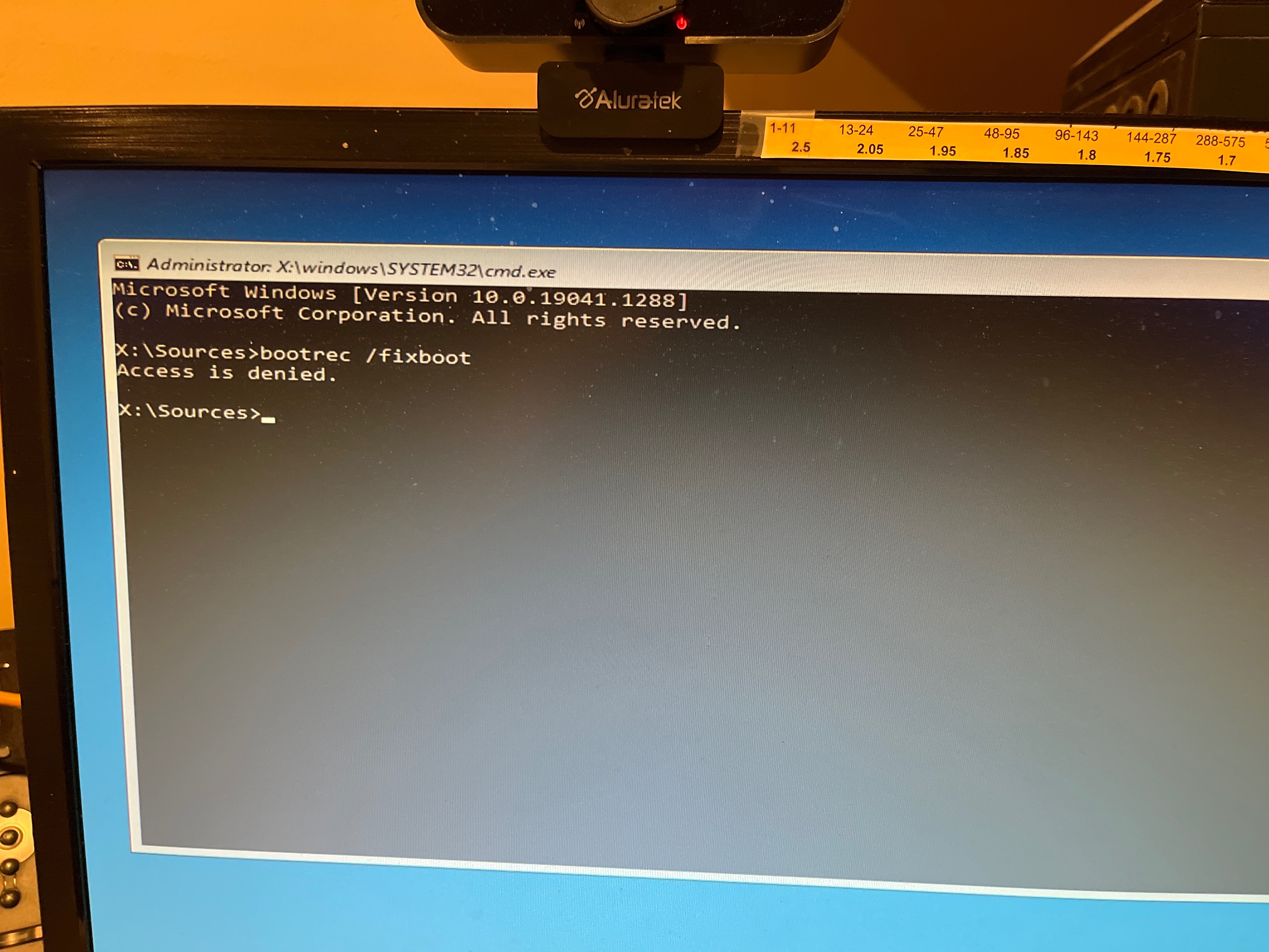

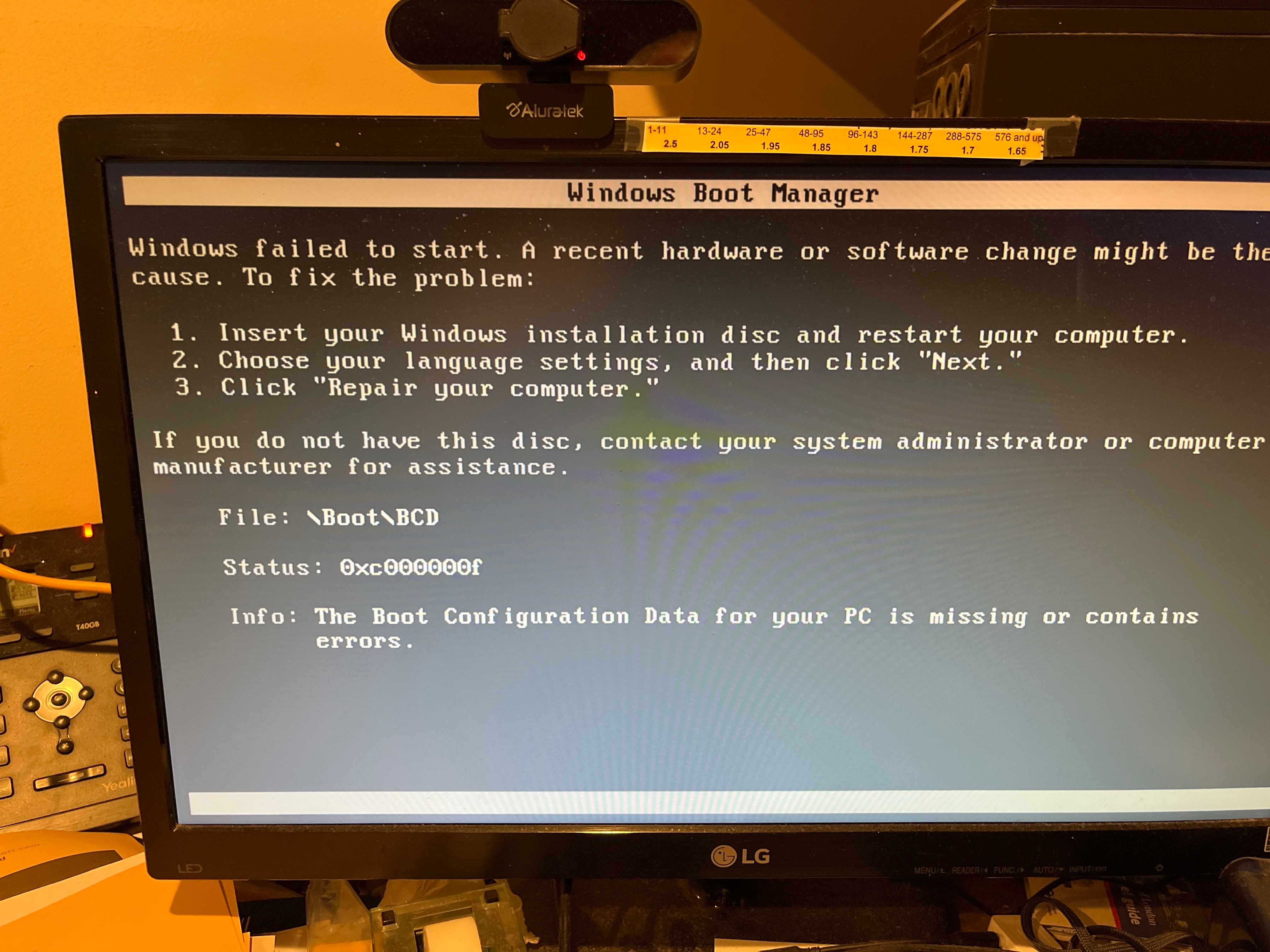

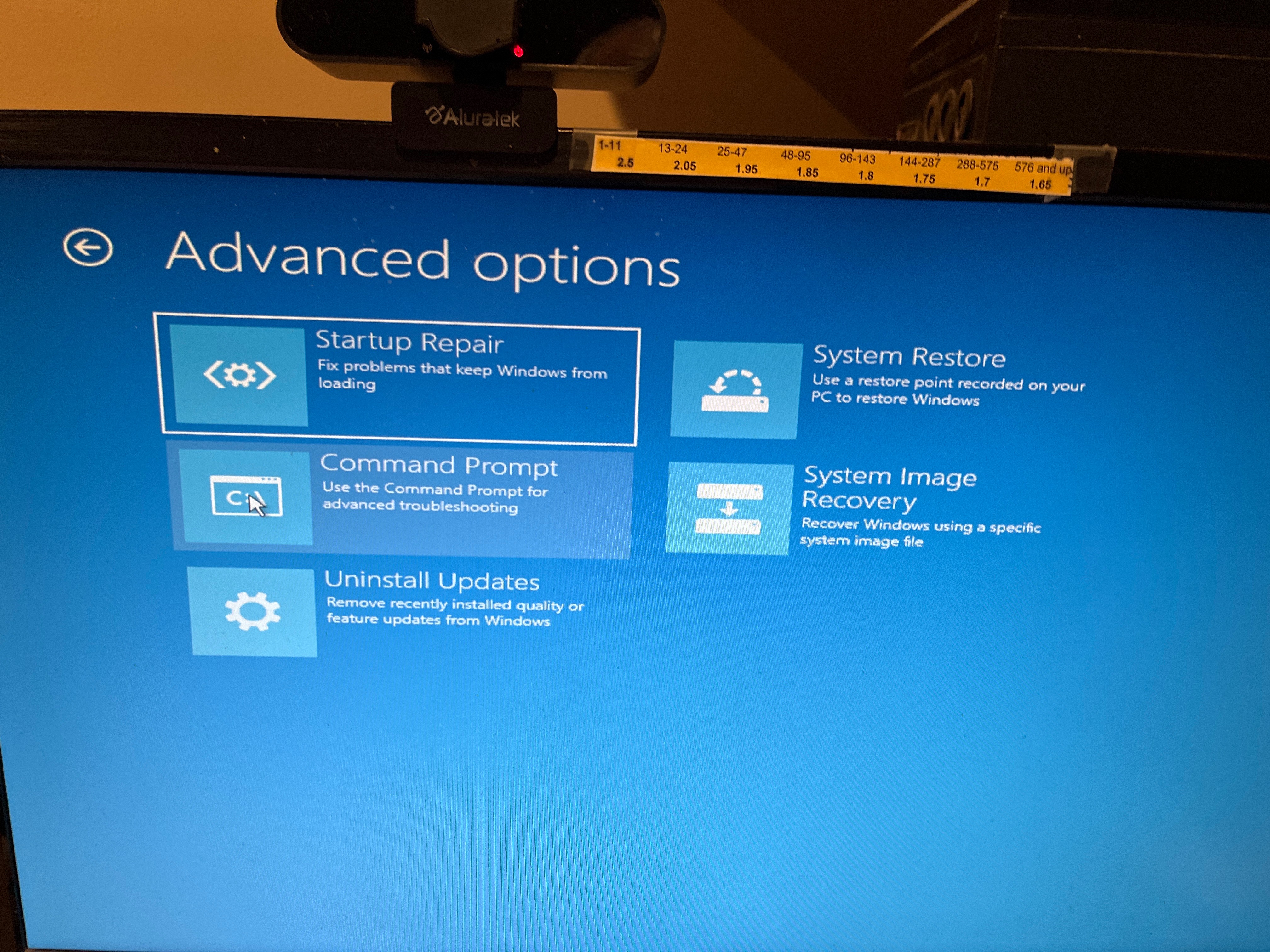

I found my computer try in to boot but goes to a blue screen then trying to repair it but is not working.
Then I want to command prompt and I try to run bootrec.exe/fix boot I got access denied.
Then I trough Diskpart
I rename the Valium in my case drive c: (where I thing the boot sector is) is volume 2, I rename value 2 to volume v: then exit
Cd v:
Then md \efi\microsoft\boot
Then cd /d v:\efi\microsoft\boot
Then bootrec.exe/fixboot
Then I got access is denied
I need help pas this problem please

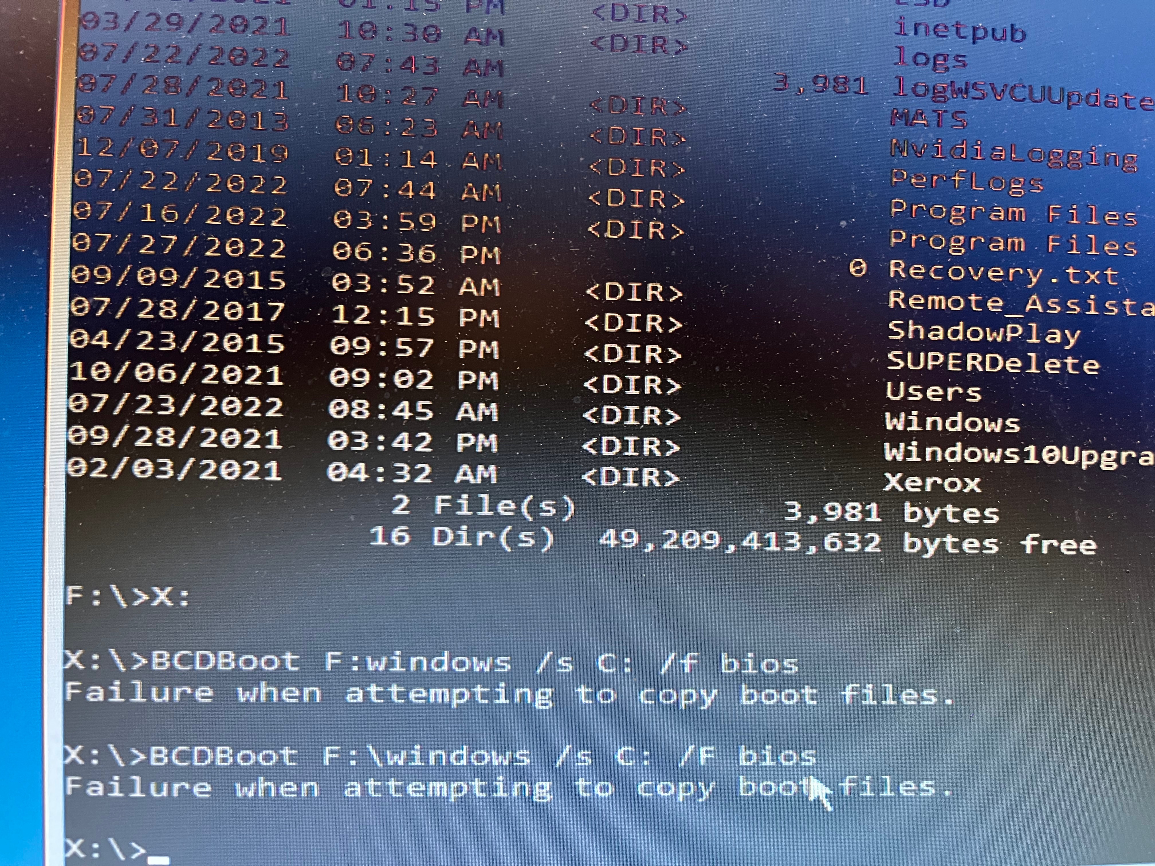

    Generally, I'm here through the wee hours. A pity BCDBoot is refusing to work. Well, let's see that BCDEdit output & BIOS Setup as well. Make it the following for BCDEdit...
    BCDEdit /Enum All
    ...though, actually, likely there is no output at all, since it depends on the contents of the System Reserved partition which we can't seem to fill.

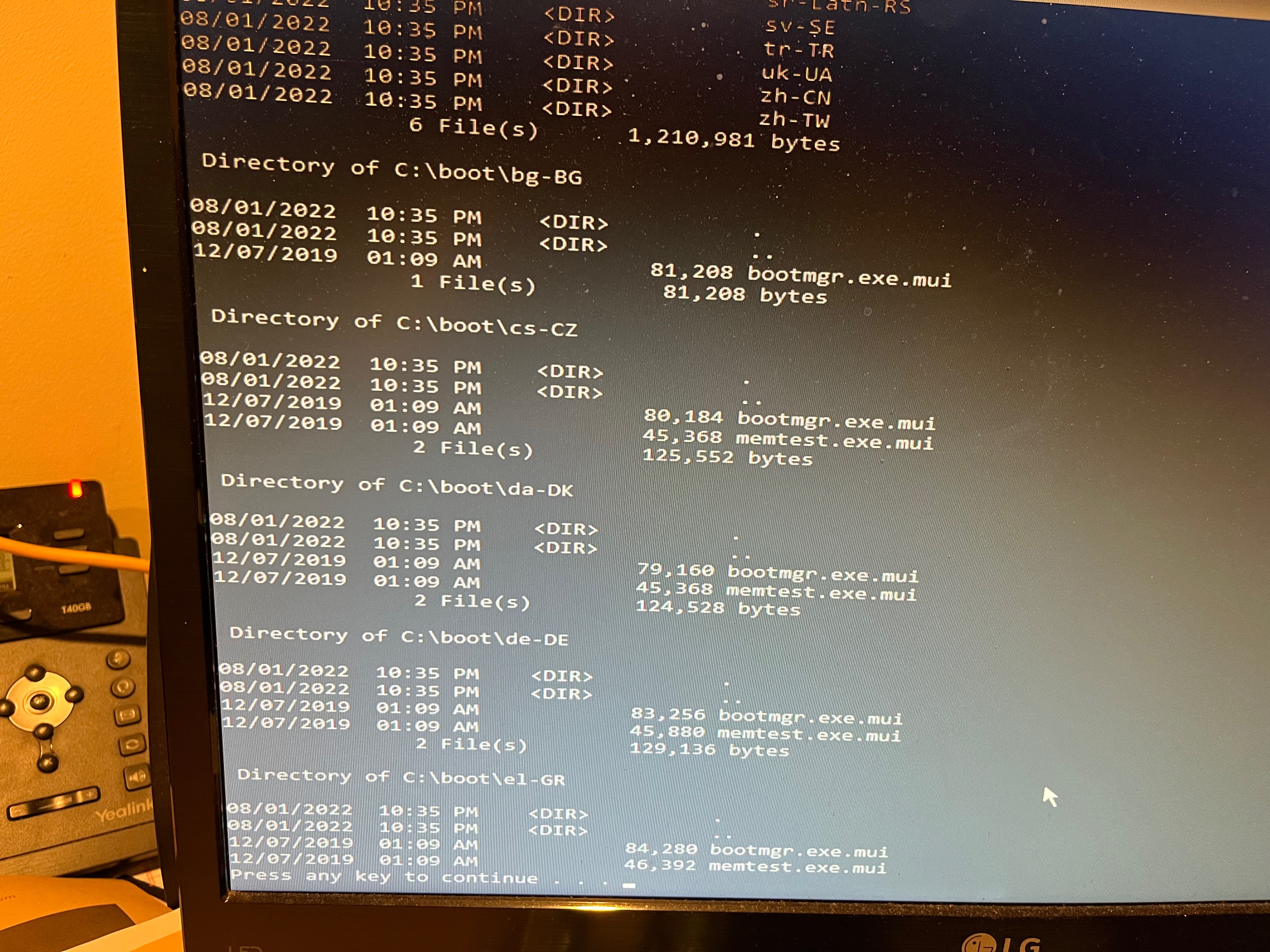

    2022-08-02T02:02:01+00:00
    Yes, that is the Windows partition with a Windows folder, but...
    You left out the backslash after F:. It might make a difference....
    BCDBoot F:\Windows /s C: /f BIOS

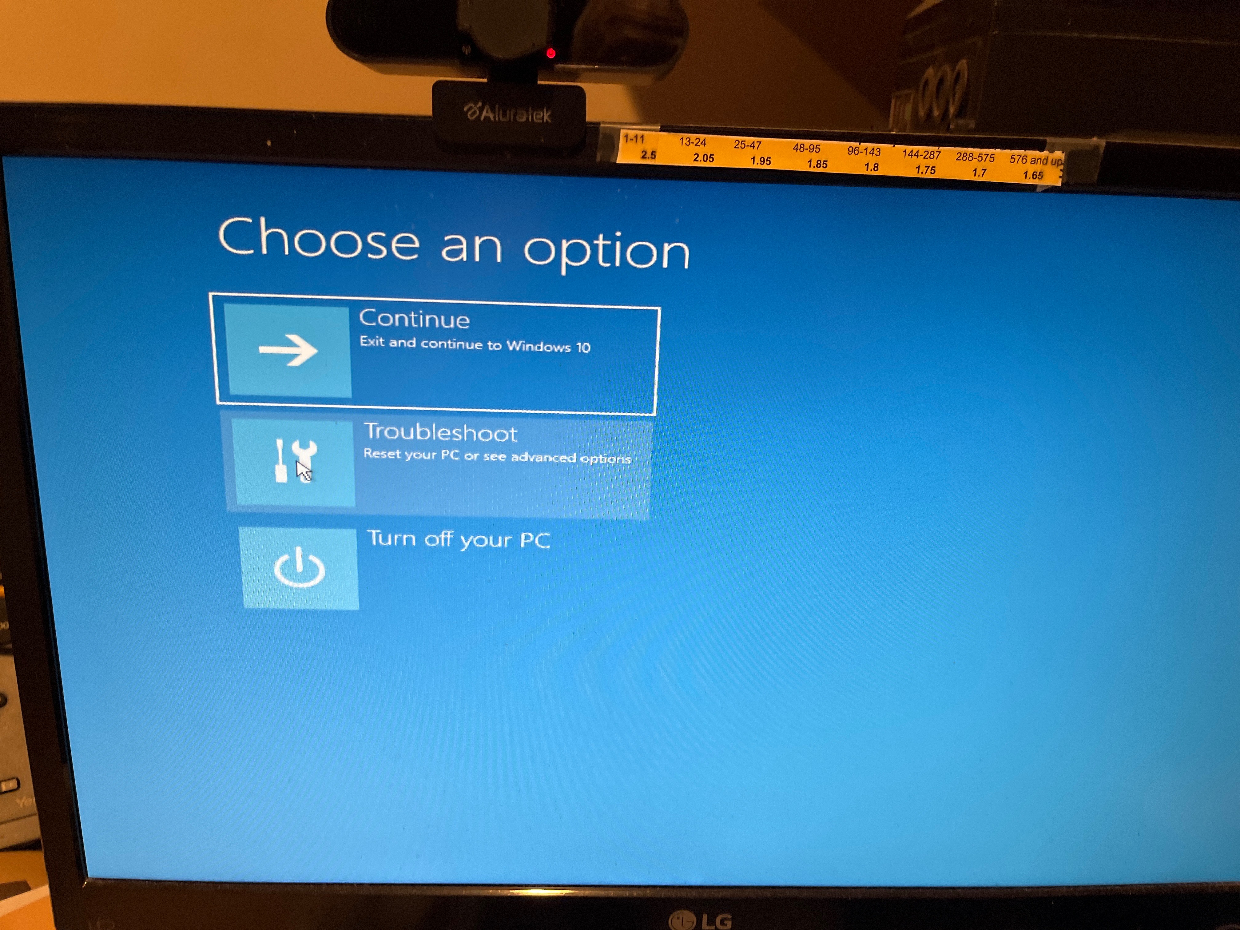

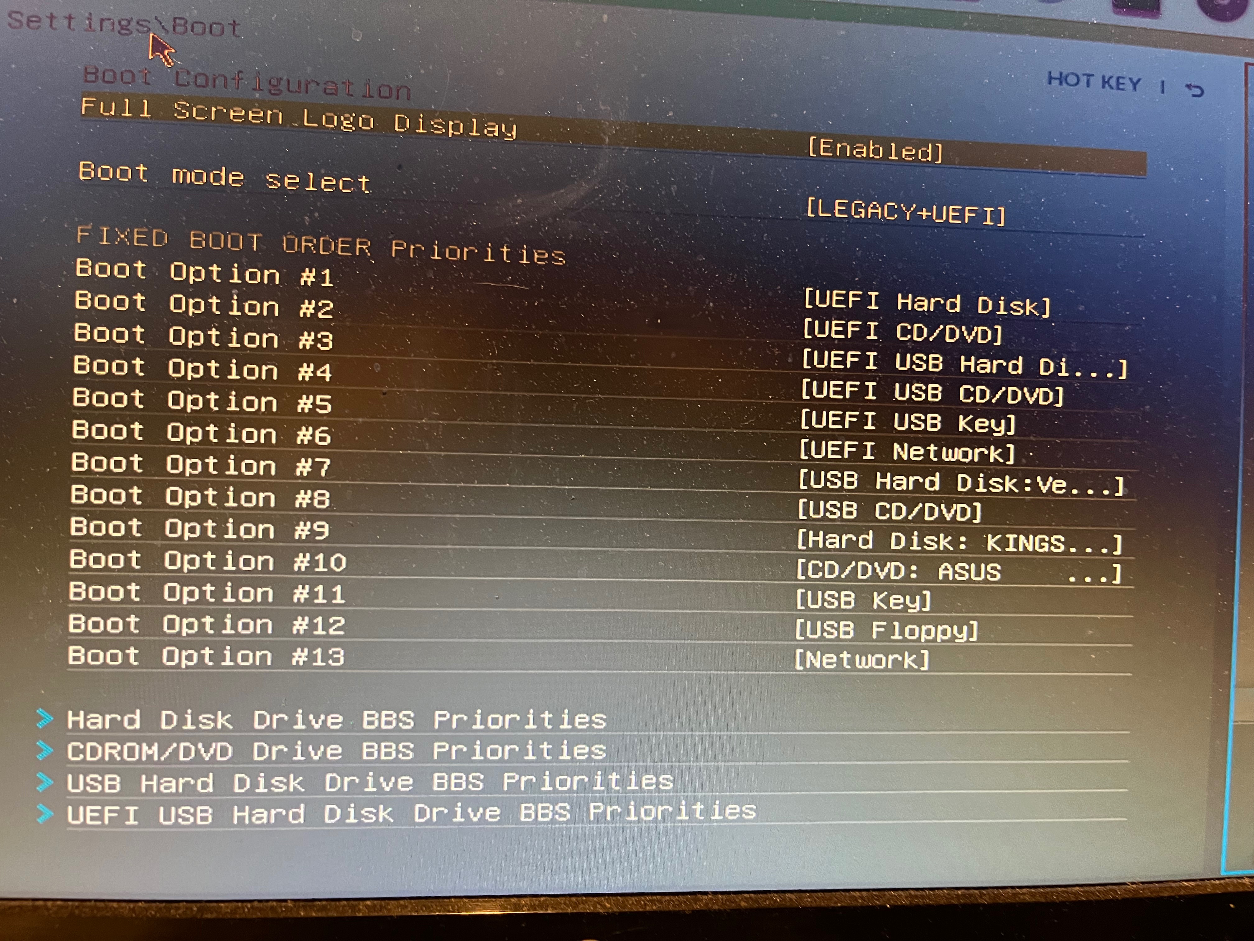

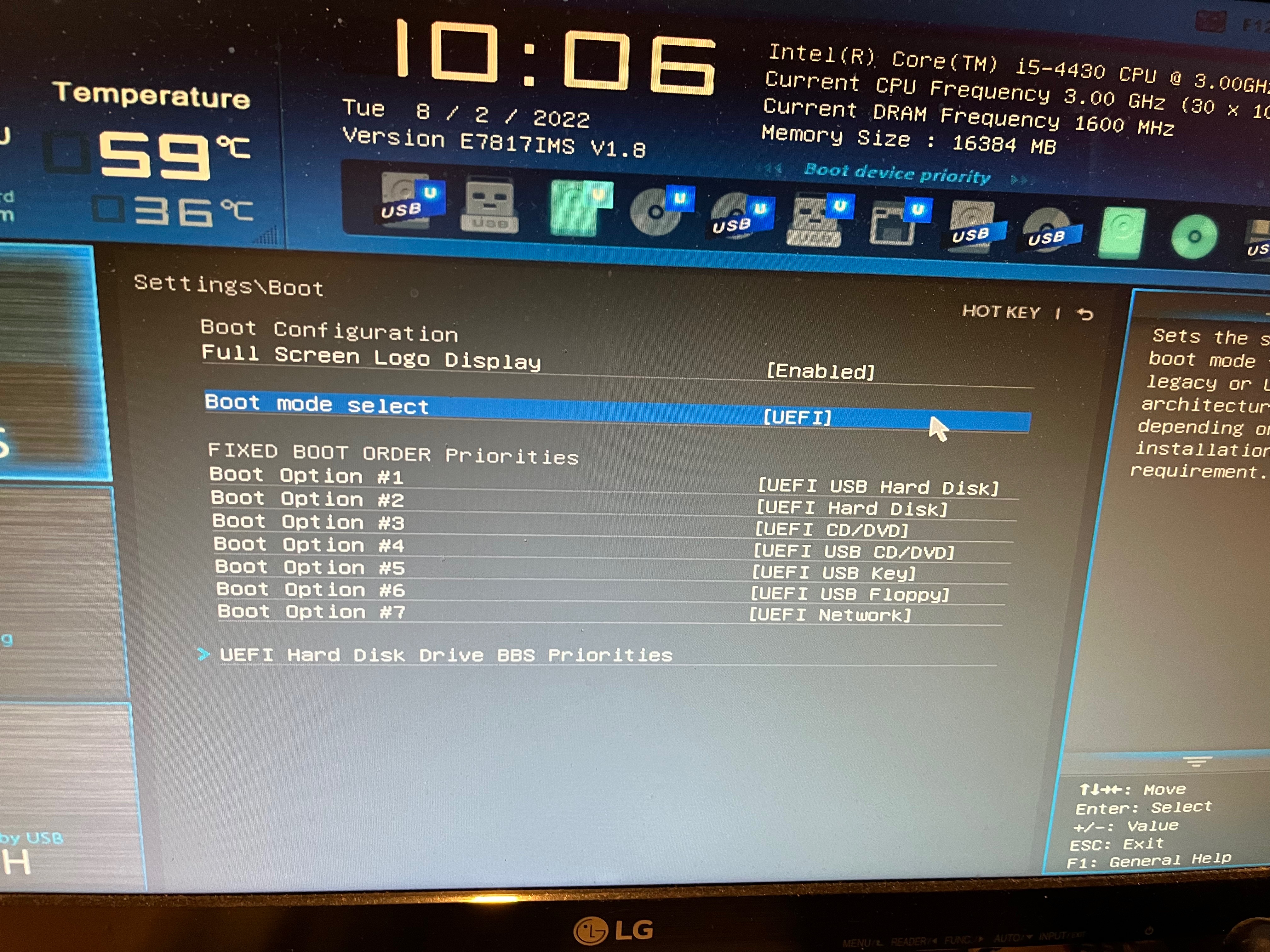

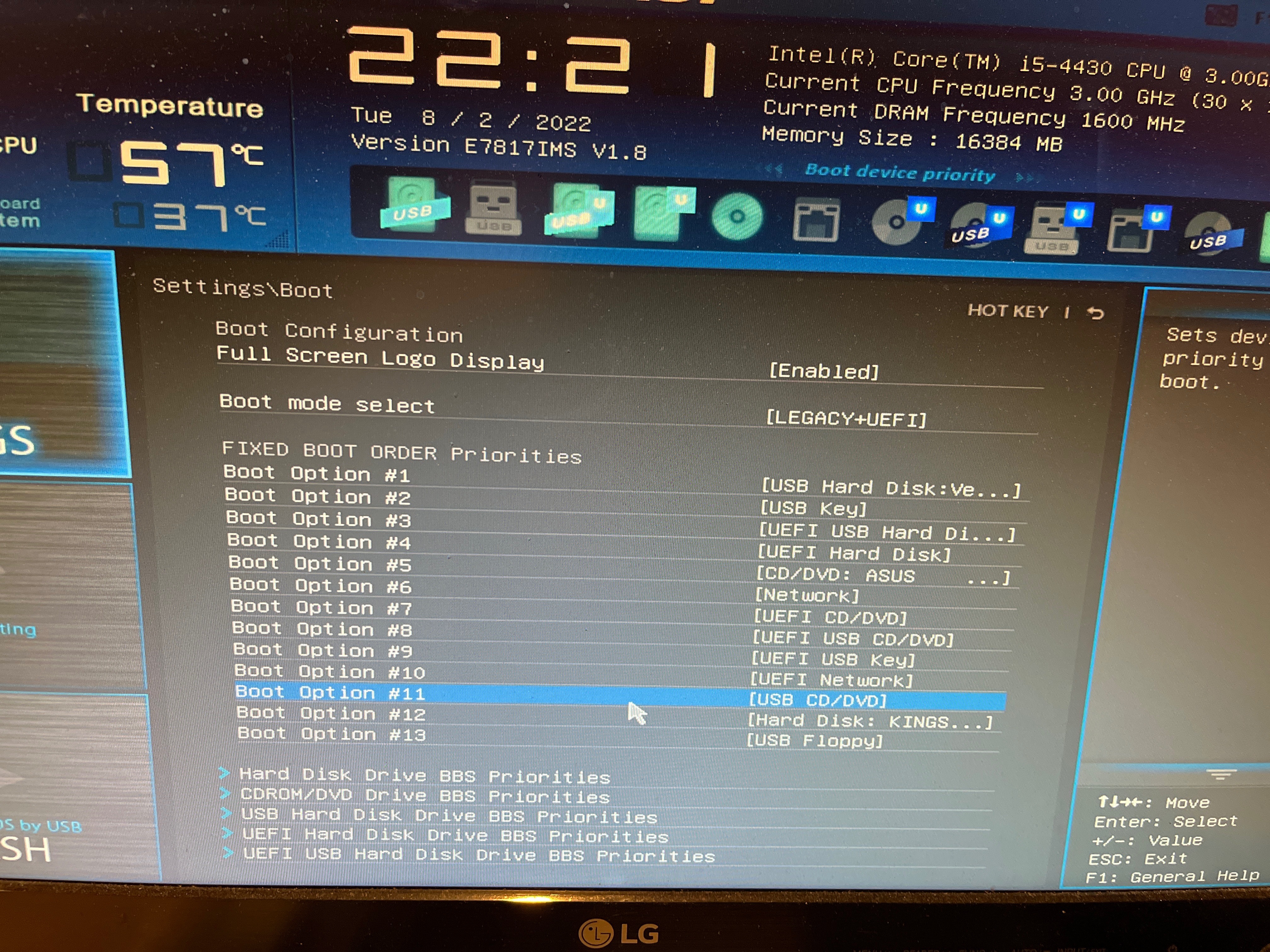

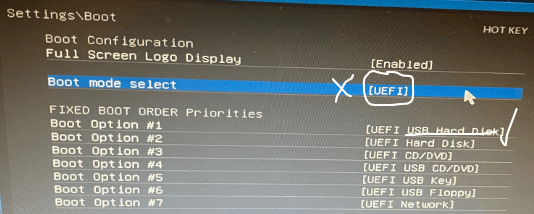

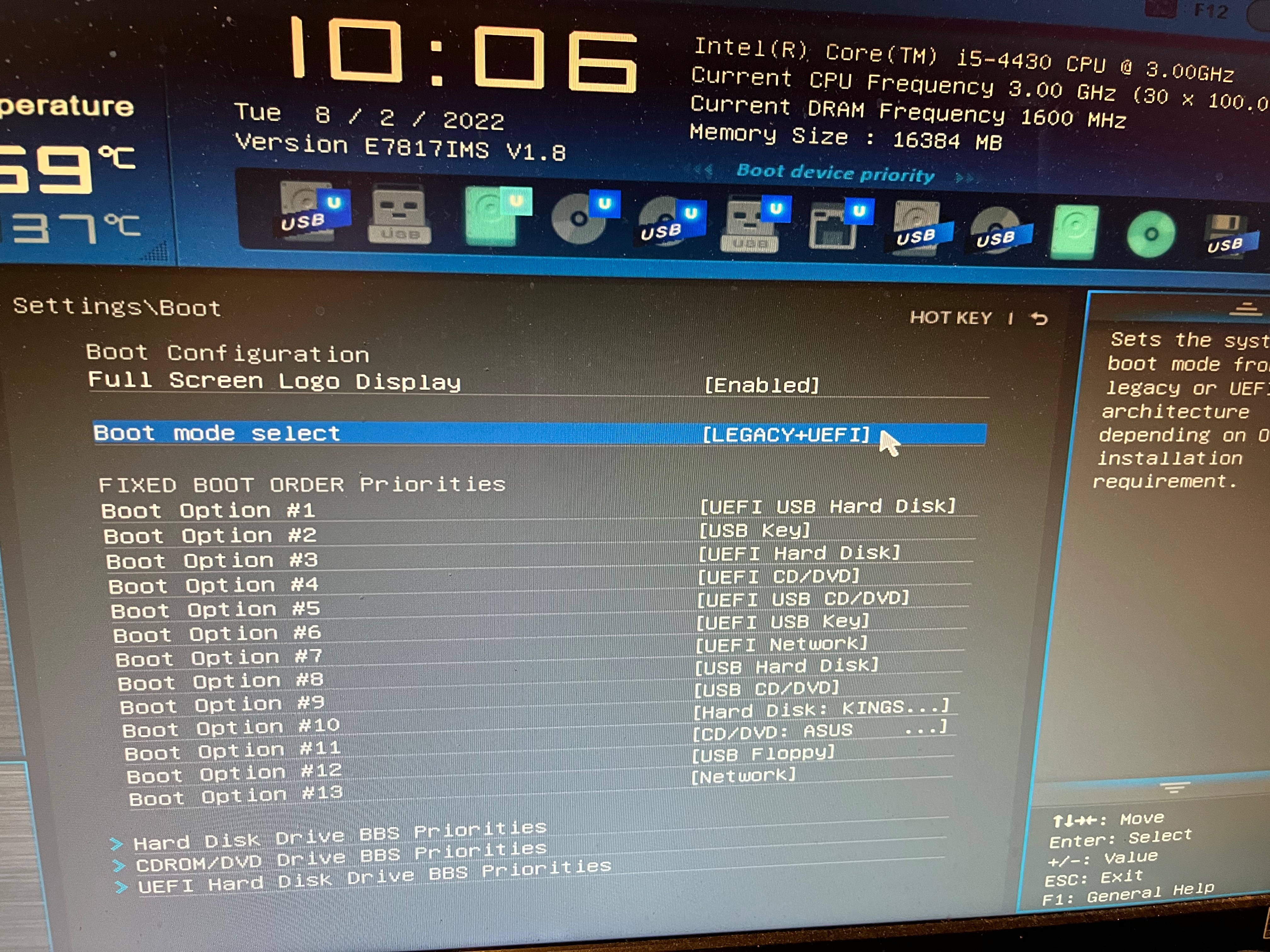

    You need to be in Legacy Mode (not UEFI mode) in order to boot a Legacy installation which is what you've got. Go into BIOS Setup this way from the "Choose an Option" screen...
    "Troubleshoot > Advanced Options > UEFI Firmware Settings"
    If you can't determine what mode it is in, post pictures of the various screens, especially the Boot Menu screen. Maybe post the pictures anyway. If you still cannot boot after that, post a picture of...
    BCDEdit
    ...issued at the Command Prompt. Remember, you can scroll the window up/down in case the top goes out of view with the scrollbar at right.
