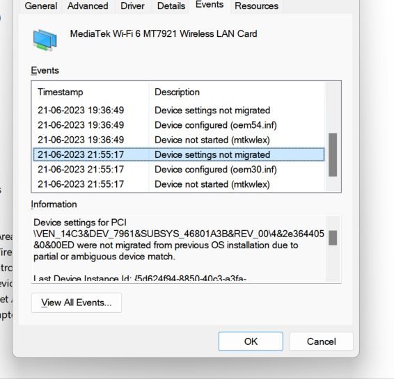

    May be can you try reinstalling Windows 11 or Windows 10, the main reason I found out was that the drivers of the adapter were mismatching with the current OS version of my Windows 11. When I checked the event logs of the Wi-Fi adapter I found the following, and figured out that the problem was with the OS rather than the device, have a look at your adapter's event logs before it turns off or uninstalls.
