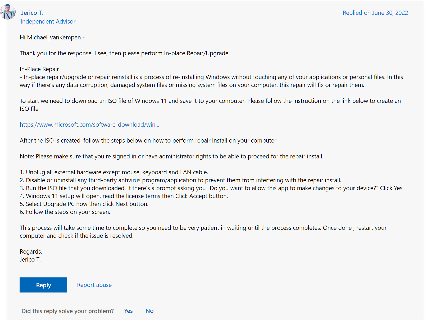

    Possibly. But after I did an in place repair upgrade, when it was doing updates, the .NET and some others installed ok but when it got the cumulative update, not KB5014668, it did the same thing and failed, but with a different error code. I'm not sure of the number but when I did the repair, I think I was on .313 verson and it was just trying to update to the latest. But since it was a bunch of updates, who knows what order it was going in. I'm hoping John DeV or another moderator shows up soon.
