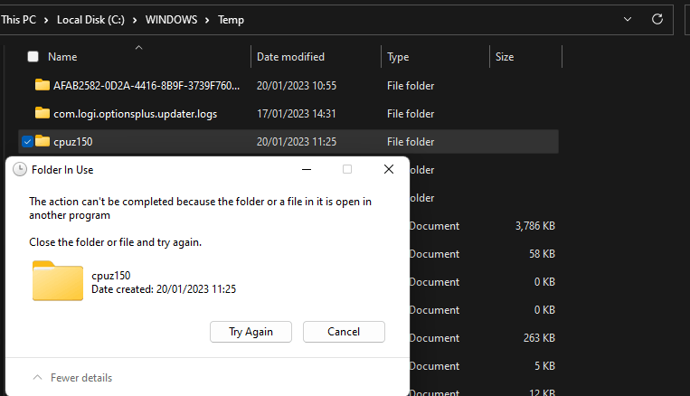

I was able to locate this temp file, but I'm not able to delete it:

The event log tells that the last driver installation was done at 08:25:39 UTC time. So nothing has been installed in the last 5 hrs or so.
  • <Event xmlns="**http://schemas.microsoft.com/win/2004/08/events/event**">
  • <System> <Provider Name="Service Control Manager" Guid="{555908d1-a6d7-4695-8e1e-26931d2012f4}" EventSourceName="Service Control Manager" /><EventID Qualifiers="16384">7045</EventID><Version>0</Version><Level>4</Level><Task>0</Task><Opcode>0</Opcode><Keywords>0x8080000000000000</Keywords><TimeCreated SystemTime="2023-01-20T08:25:39.2452376Z" /><EventRecordID>24353</EventRecordID><Correlation /><Execution ProcessID="1368" ThreadID="9444" /><Channel>System</Channel><Computer>MIR_PC</Computer><Security UserID="S-1-5-21-329695934-4175040297-455591349-1001" /></System>
  • <EventData> <Data Name="ServiceName">cpuz150</Data><Data Name="ImagePath">C:\WINDOWS\temp\cpuz150\cpuz150_x64.sys</Data><Data Name="ServiceType">kernel mode driver</Data><Data Name="StartType">demand start</Data><Data Name="AccountName" /></EventData> </Event>
This SID is responsible for S-1-5-21-329695934-4175040297-455591349-1001 creating the service.
Check if this is your SID by running "whoami /user"
Disable all third-party services using MSCONFIG.
Run this command to delete the CPU ID service.
SC.EXE DELETE CPUZ50
In Autoruns, disable all 3rd party scheduled tasks:
Restart Windows.
