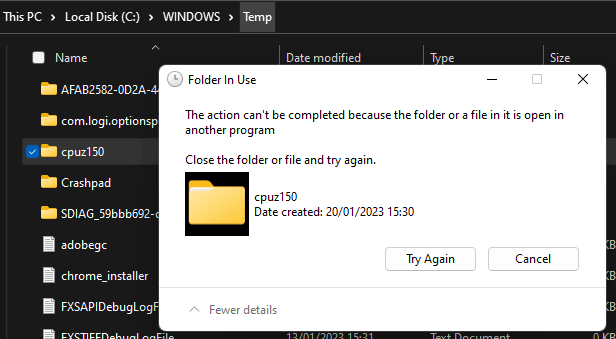

I was able to locate this temp file, but I'm not able to delete it:

The event log tells that the last driver installation was done at 08:25:39 UTC time. So nothing has been installed in the last 5 hrs or so.
  • <Event xmlns="**http://schemas.microsoft.com/win/2004/08/events/event**">
  • <System> <Provider Name="Service Control Manager" Guid="{555908d1-a6d7-4695-8e1e-26931d2012f4}" EventSourceName="Service Control Manager" /><EventID Qualifiers="16384">7045</EventID><Version>0</Version><Level>4</Level><Task>0</Task><Opcode>0</Opcode><Keywords>0x8080000000000000</Keywords><TimeCreated SystemTime="2023-01-20T08:25:39.2452376Z" /><EventRecordID>24353</EventRecordID><Correlation /><Execution ProcessID="1368" ThreadID="9444" /><Channel>System</Channel><Computer>MIR_PC</Computer><Security UserID="S-1-5-21-329695934-4175040297-455591349-1001" /></System>
  • <EventData> <Data Name="ServiceName">cpuz150</Data><Data Name="ImagePath">C:\WINDOWS\temp\cpuz150\cpuz150_x64.sys</Data><Data Name="ServiceType">kernel mode driver</Data><Data Name="StartType">demand start</Data><Data Name="AccountName" /></EventData> </Event>
This SID is responsible for S-1-5-21-329695934-4175040297-455591349-1001 creating the service.
Check if this is your SID by running "whoami /user"
Disable all third-party services using MSCONFIG.
Run this command to delete the CPU ID service.
SC.EXE DELETE CPUZ50
In Autoruns, disable all 3rd party scheduled tasks:
Restart Windows.

  1. Ramesh 181.9K Reputation points Volunteer Moderator
    2023-01-20T13:50:59+00:00
    C:\WINDOWS\system32>SC.EXE DELETE CPUZ50
    [SC] OpenService FAILED 1060:
    The specified service does not exist as an installed service.
    The CPUZ50 service is gone. It hasn't reappeared.
    It's all sorted now?
    2023-01-20T13:57:07+00:00
    No it still hasn't been fixed :(
  3. Ramesh 181.9K Reputation points Volunteer Moderator
    2023-01-20T14:00:24+00:00
    Restarting Windows should take care of that issue. The last time you didn't restart the machine; you may have used the "shutdown" option instead.
    Go to Start, select the Power button, and then select Restart (instead of Shutdown)
    If the service re-appears (it shouldn't), pls post back.
    2023-01-20T14:11:43+00:00
    Hey there, Thanks it worked and the cpuz150 isn't appearing currently!
    Should I try updating now? and also were the startup apps the reason for what happened or can I turn them back on now?
    Thanks again! :)
    ps -Last time I did restart :)
