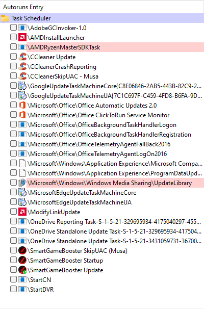

In Autoruns, disable all 3rd party scheduled tasks:
Restart Windows.
    Restart Windows.

    Last Step done:
    Should I still restart?
