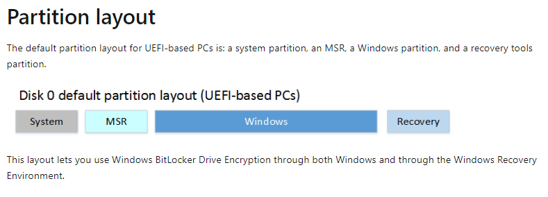

    @Tage: See recommended partition layout (MSFT article)
    My idea is to nuke Vol 3 or make it a regular partition without deleting it. Then shrink C by 500 MB, create a new EFI of size 500 MB, and rebuild the EFI Boot Partition, BCD and Boot Files. But suggest creating a system image backup of the OS and boot partitions using Macrium, beforehand.
