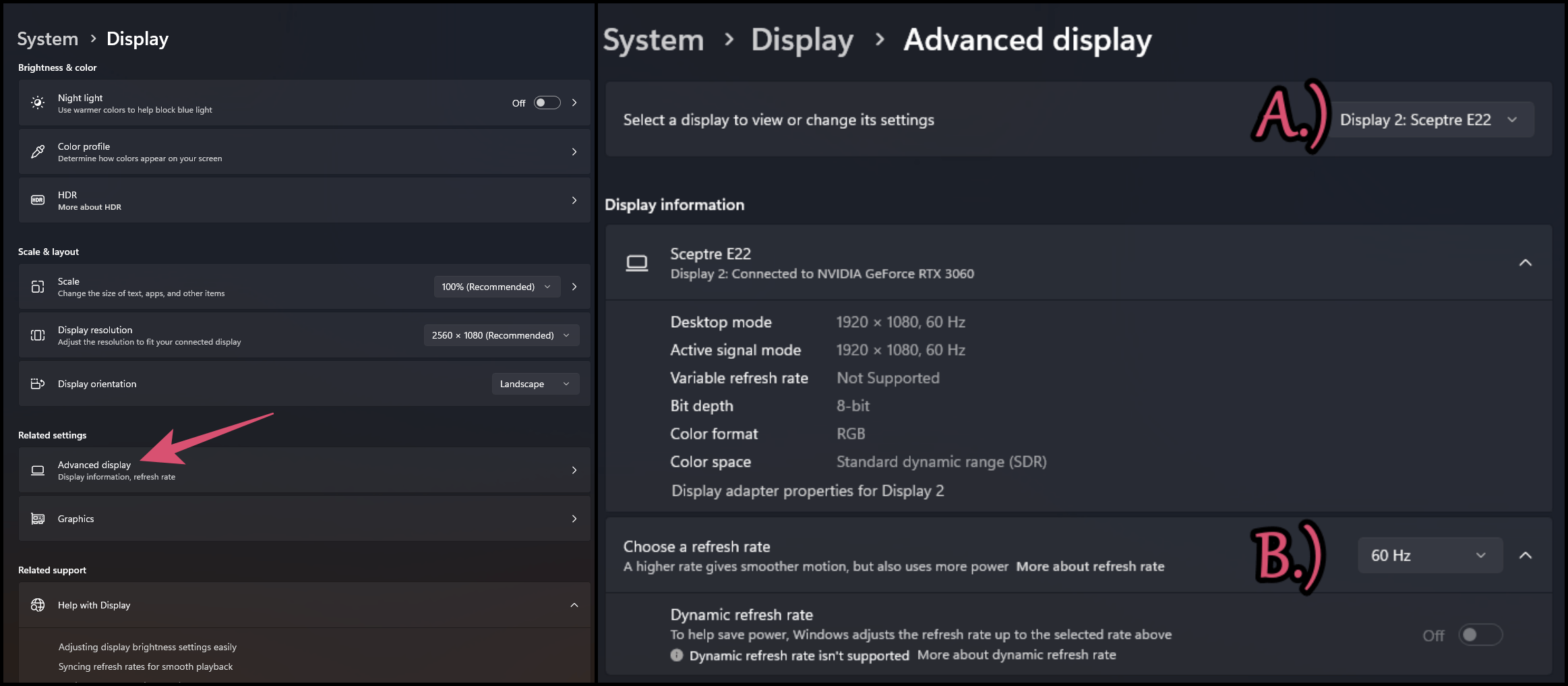

    Win 11 you have to scroll down to advanced display (I'm sure 10 is similar) then A.) select your monitor; B.) select your refresh rate.
