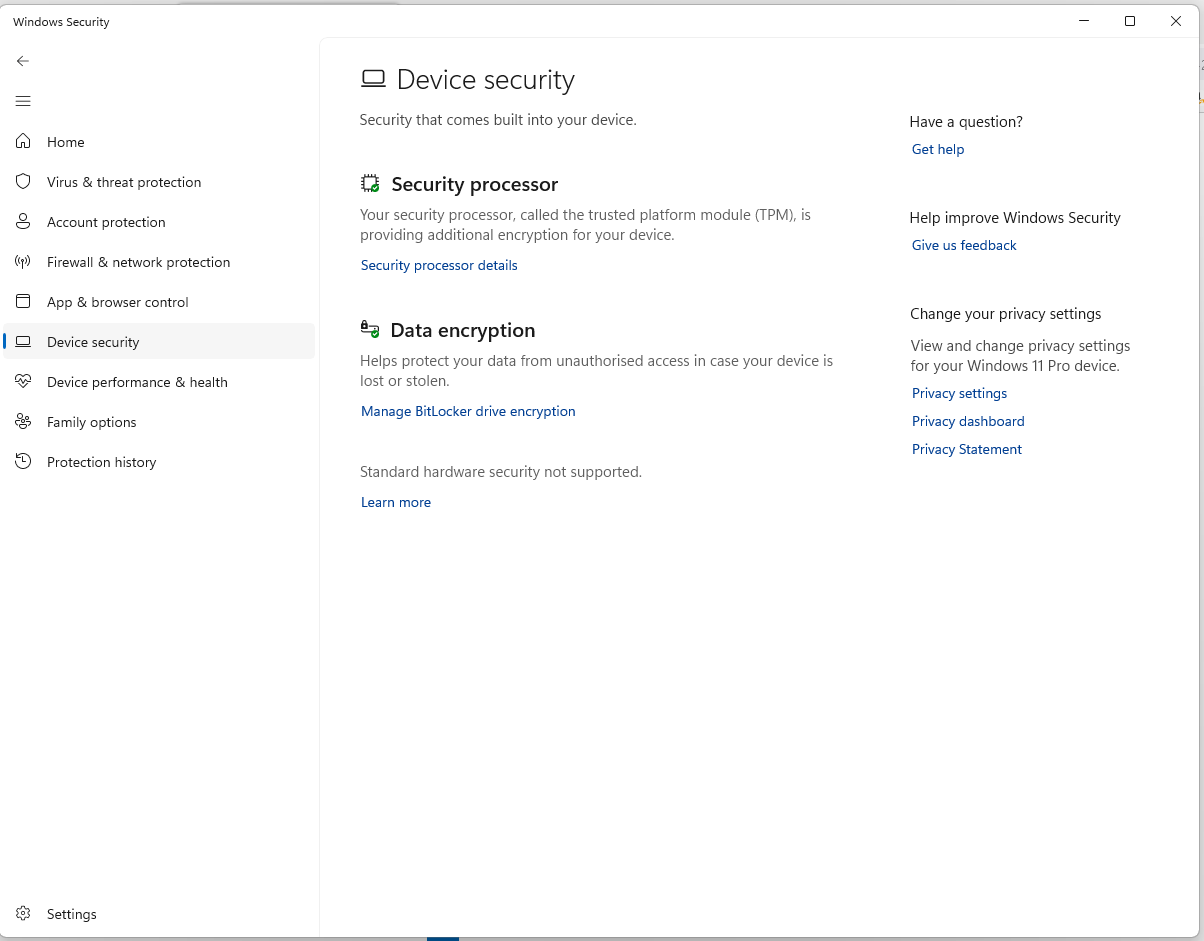

After I uninstalled Avira Antimalware, I got an alert from Windows Security that my Local Security Authority Protection was turned off. But after I turned it on and restarted as instructed, I continue to get the same alert that my Local Security Authority Protection is turned off, even though within the same window, the toggle switch under the "Local Security Authority Protection" heading displays that it's already turned on.
