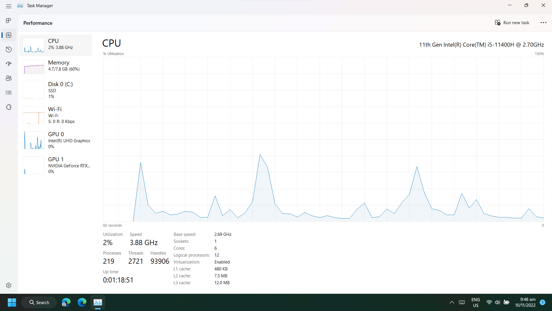

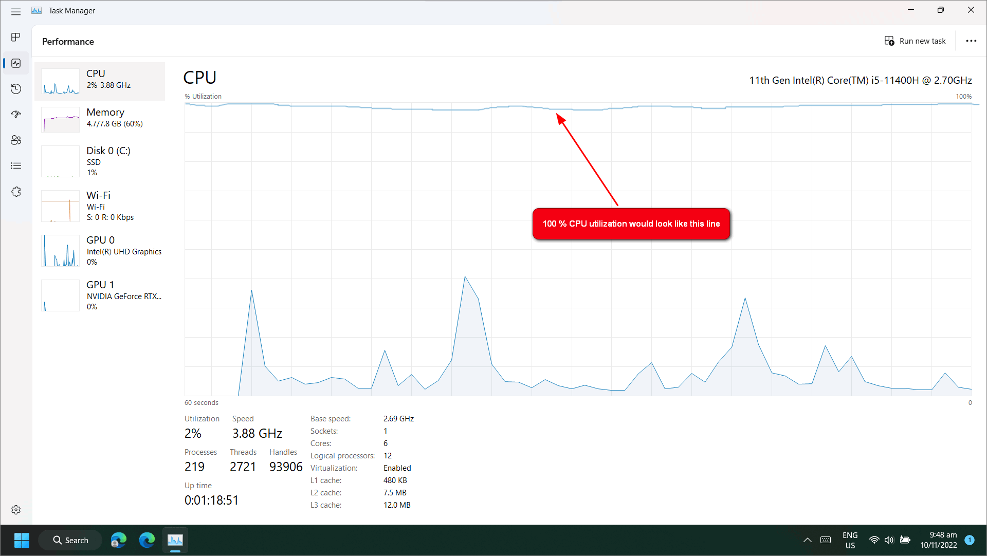

_AW_ 69,416 Reputation points Volunteer Moderator
2022-11-10T02:51:45+00:00
I'm not seeing anything abnormal with CPU. I think it's likely that you are misinterpreting the graph when on the performance tab. The bottom of the graph is 0 % and the top is 100%. For 100 % CPU utilization, the blue line would be a straight line across the top of the graph.

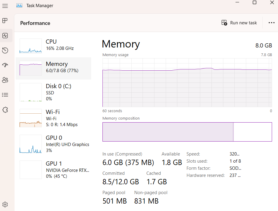

2022-11-24T01:06:32+00:00
It could be that one of the RAM sticks has come loose and needs to be reseated. If that's a task you'd want to tackle, the video linked below gives an idea of what is involved.
https://www.youtube.com/watch?v=L-kzlPu-wCc
This shows what's involved in cleaning then reinstalling the RAM.
https://computerinfobits.com/how-to-clean-ram-contacts/

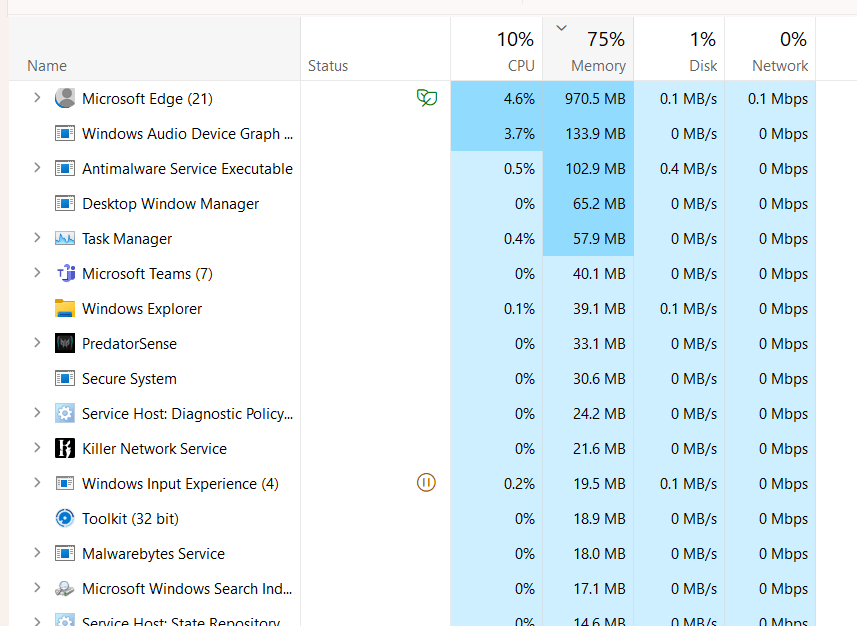

2022-11-23T23:18:36+00:00
Hi, the disk is fine, the memory could possibly be high. Open Task Manager, switch to the Performance tab and select Memory. Post a screenshot.
Switch to the Processes tab, and click at the top of the Memory column so it's sorted high to low - make sure it's scrolled to the top so I can see the highest memory consumption. Post a screenshot.

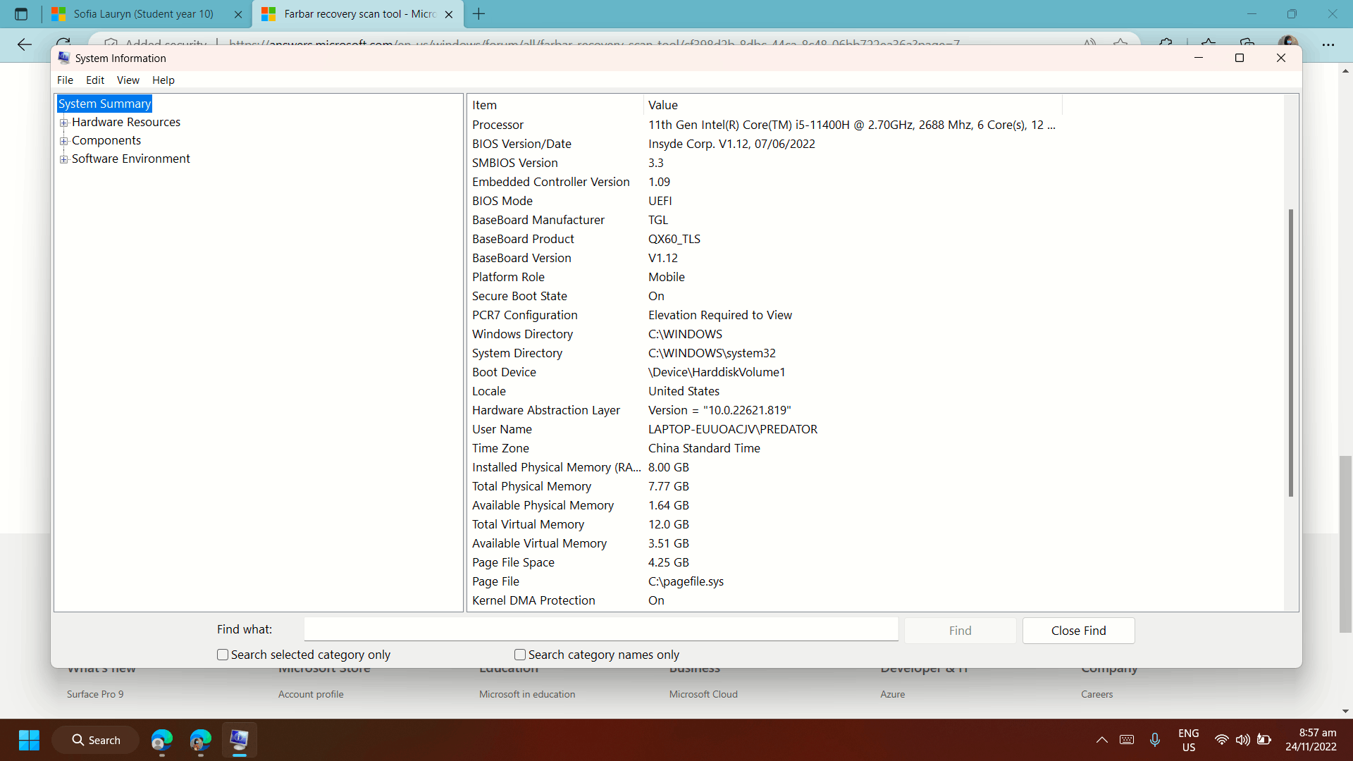

2022-11-21T22:45:30+00:00
No, that will be embedded in the BIOS or UEFI firmware.

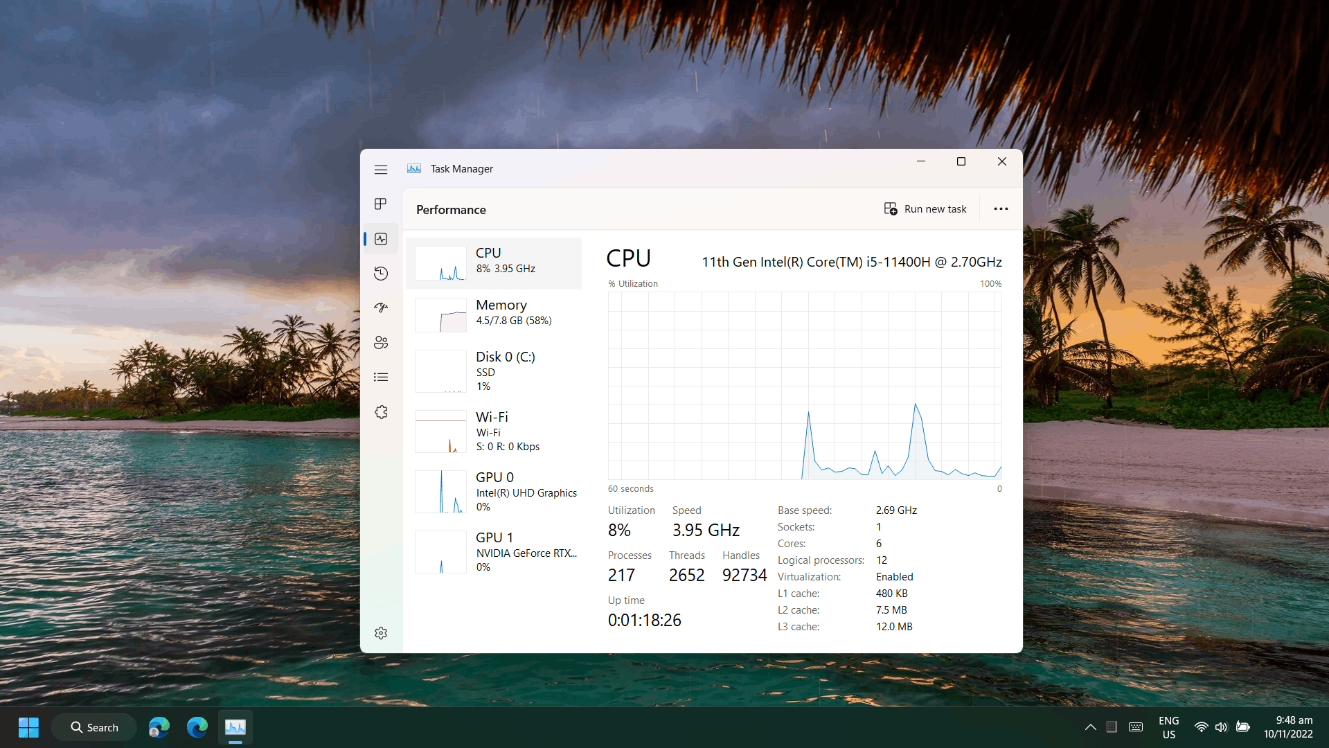

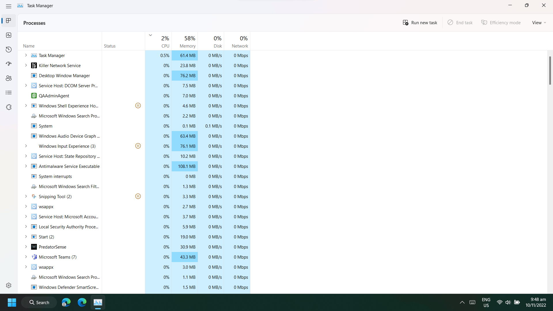

2022-11-11T00:32:12+00:00
CPU and CPU utilization are the same thing.
>>Also, why is my CPU utilization being high when there are no apps running?
Even though you're not running any apps, there's still 219 processes running on your system. My system shows around 210 processes. There are many operating system related tasks, and Windows Defender tasks, that are triggered when the system is "idle". To see what is happening when those spikes in the graph occur, switch to the Processes tab in TM and sort the CPU column from high to low.
2022-11-10T03:14:52+00:00
That's just to show that the top of the graph corresponds to 100 % CPU utilization.

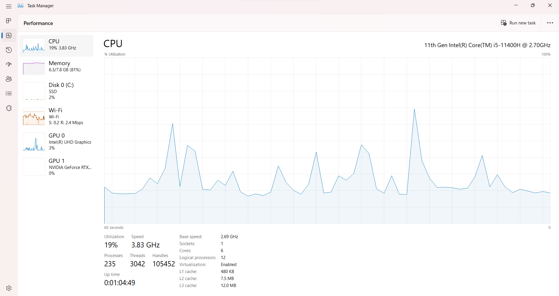

2022-11-10T01:29:09+00:00
There's no malware present. Post a screenshot showing the 100% CPU utilization.
Also, select the processes tab in Task Manager, click in the CPU header to sort from high to low. Post a screenshot of that.
