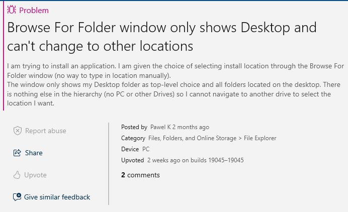

In several programs, when I need to set a folder location for example, and open the Browse Dialog, I'm only shown the Desktop folder. I can't access any folder outside of "Desktop". It doesn't make a difference to run the programs as admin.
