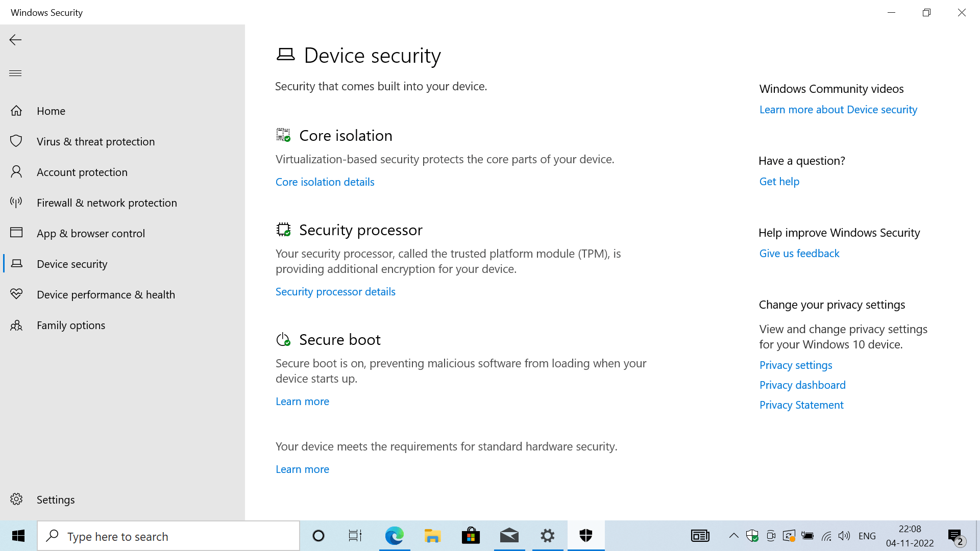

    My Windows 11 Started Lagging. This Security Processor has been solved by Going Back to Windows 10. I Rolled Back and Now It's Showing Everything Fine. In Windows 11 22H2 the Bug is Heavily Distributed. Earlier I was also facing the same issue of missing secure boot, check my earlier post for details. Also Do Post Here in Thread Once the Issue is Solved in 22H2, I'll Upgrade my PC as option is available.
