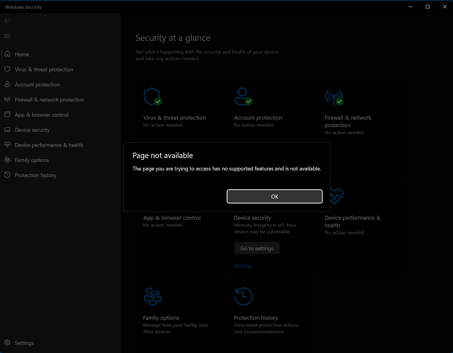

'Standard hardware security not supported', till now the error is not fixed in Version 10.0.22621.674 also.
2022-10-14T15:30:26+00:00
Is Microsoft aware of this issue and working on it?

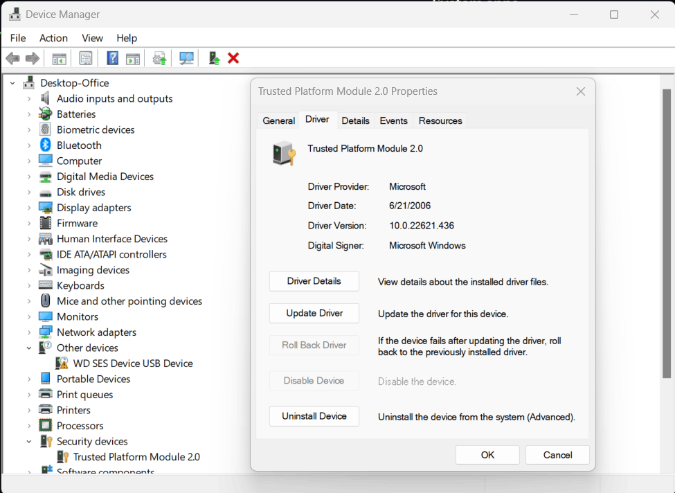

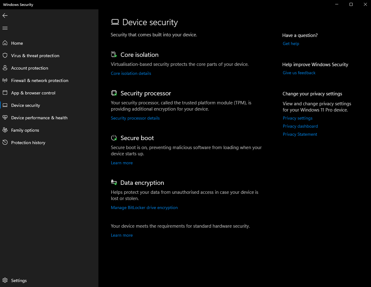

    Hi Enric,
    Thank you for this thoughtful post. I have spent hours searching for a workaround to this issue on a new i9-13900KF/Z790 platform that was falsely showing "[standard] hardware security not supported" when everything, including BitLocker was working just fine. I did come up a workaround like yours that expected there to be files in the SecurityHealth directory, but mine was, like many others, empty because of a fresh install of Windows 11.
    This is most definitely a bug introduced with a later release of the security platform update. By downgrading to a prior version you posted above, downloading the file, and following the exact procedure you posted, I was able to restore proper functionality, as shown below. Before this all I would see is the "[standard] hardware security not supported" message.
    This does beg the question however - since this is well known now, why is it that it has not been fixed yet by Microsoft? (Not a question for you, just a rhetorical question.)
    In any case, thank you again. For anyone else reading, this workaround works perfectly when your SecurityHealth folder is empty.
