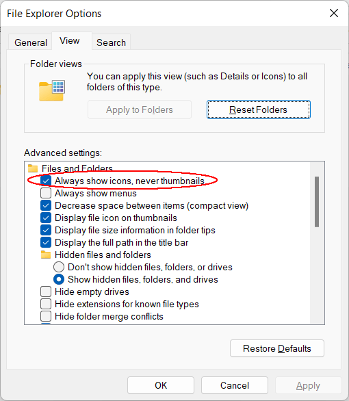

    These are the steps I did to fix the slow file explorer for myself. Not sure if it will work for everyone, but its near instant for me now.
    1. Open File Explorer.
    2. Click on the three dots menu.
    3. Click on options.
    4. click on the view tab.
    5. Enable 'Launch folder windows in a separate process".
    6. Click apply.
    7. Done!
    Hope this works!
