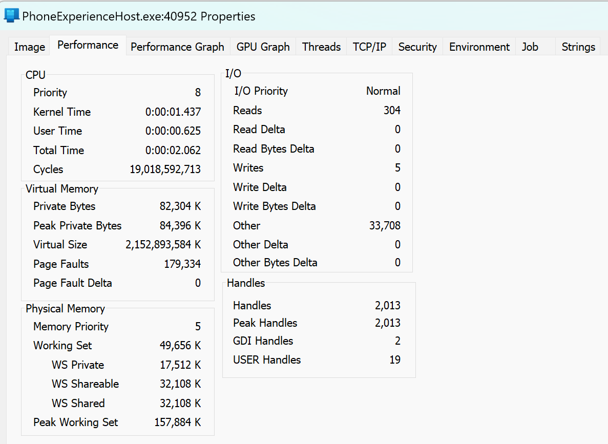

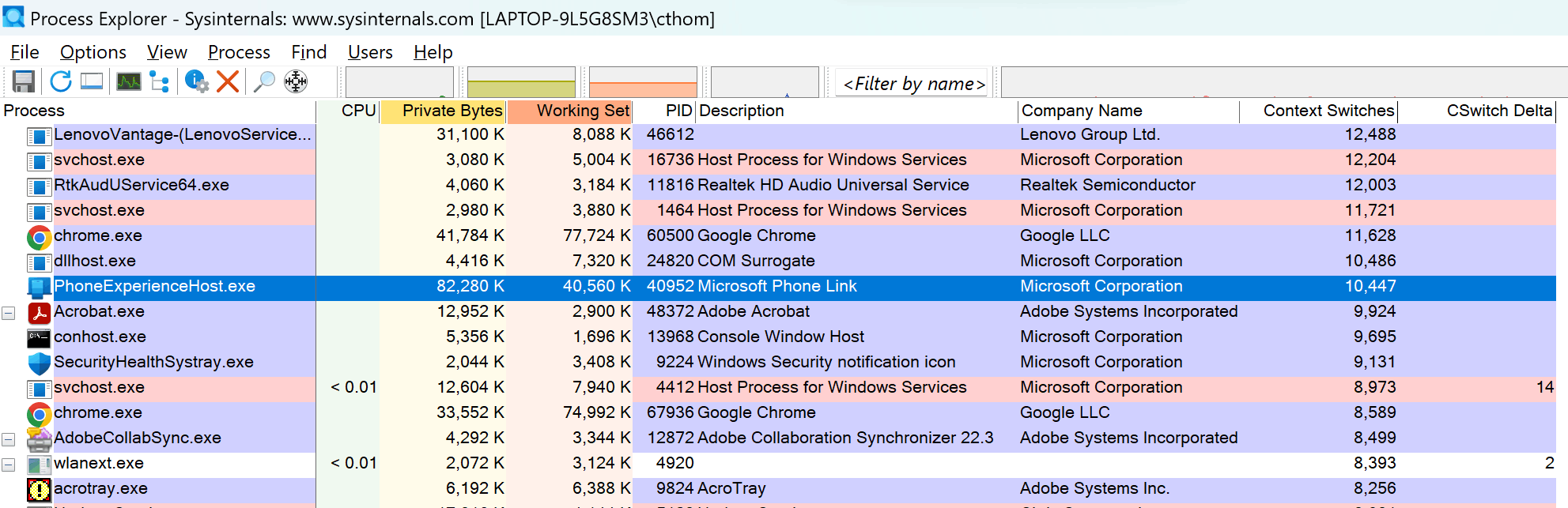

    Hi, thanks for this. I haven't had another incident of my laptop overheating from PhoneExperienceHost since a week ago (when I took my ProcExp screenshot). I didn't try to kill off PhoneExperienceHost using Task Manager at that time, instead my first response (after taking the screenshots) was to "Restart" the laptop. That was sufficient to clear my problem and I moved on. I am *very* wary of killing off Windows processes -- especially ones whose threads can gain kernel privilege -- and would do so only if it was my last-hope method for gaining enough system resource to save my currently-opened files to disk.
    It looks like you're running Process Explorer from a command line. I'm using the GUI from https://download.sysinternals.com/files/SysinternalsSuite.zip.  Now that I have a current version (I had been using v16.21 of 20 Oct 2018), I'm able to see kernel time in the process summary window. Hmmm... a thread that's in a busy loop, waiting on a flag that requires kernel privilege to read, "should" poll that flag at a low frequency -- I'd hope no more than once every ten seconds. Privilege-escalations and privilege de-escalations are expensive, and a dll with a polling loop running continuously at kernel privilege also seems a bad idea to me. Ideally this flag would be recoded as a semaphore-wait in the kernel with a callback hooked to its signal.... but that might require a major recoding of PhoneExperienceHost? Anyway I'll leave the diagnosis & repair to the Windows QA team! But... if I ever again have an overheating laptop from PhoneExperienceHost I'll take some screenshots from v17.02 Process Explorer, using the following as my baseline for a non-problematic PhoneExperienceHost:
    PhoneExperienceHost.exe is a long way down the list of processes when I sort them by total context switches during the current session of Windows11:
