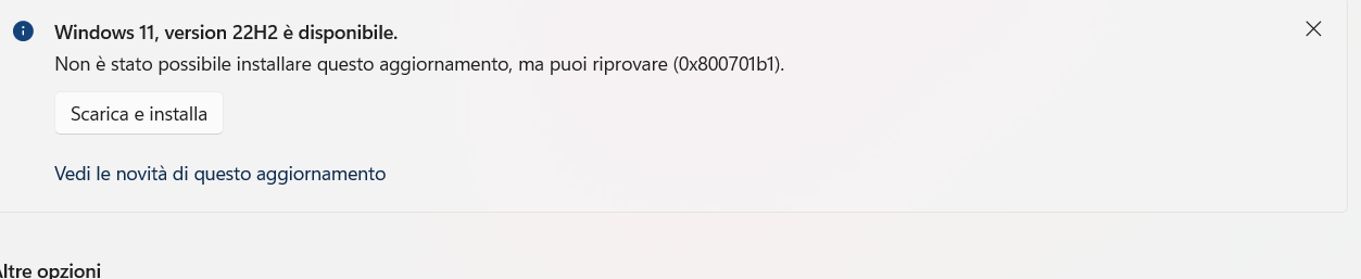

Could not update to 22h2 due to 0x800701b1 and 0xC1900101 error. Then I managed to update and boot fails, 0xc0000098 errror. What do I do?
2022-11-26T16:43:05+00:00
Well, this.
If I try to install the update after a while pc restarts and restores old version

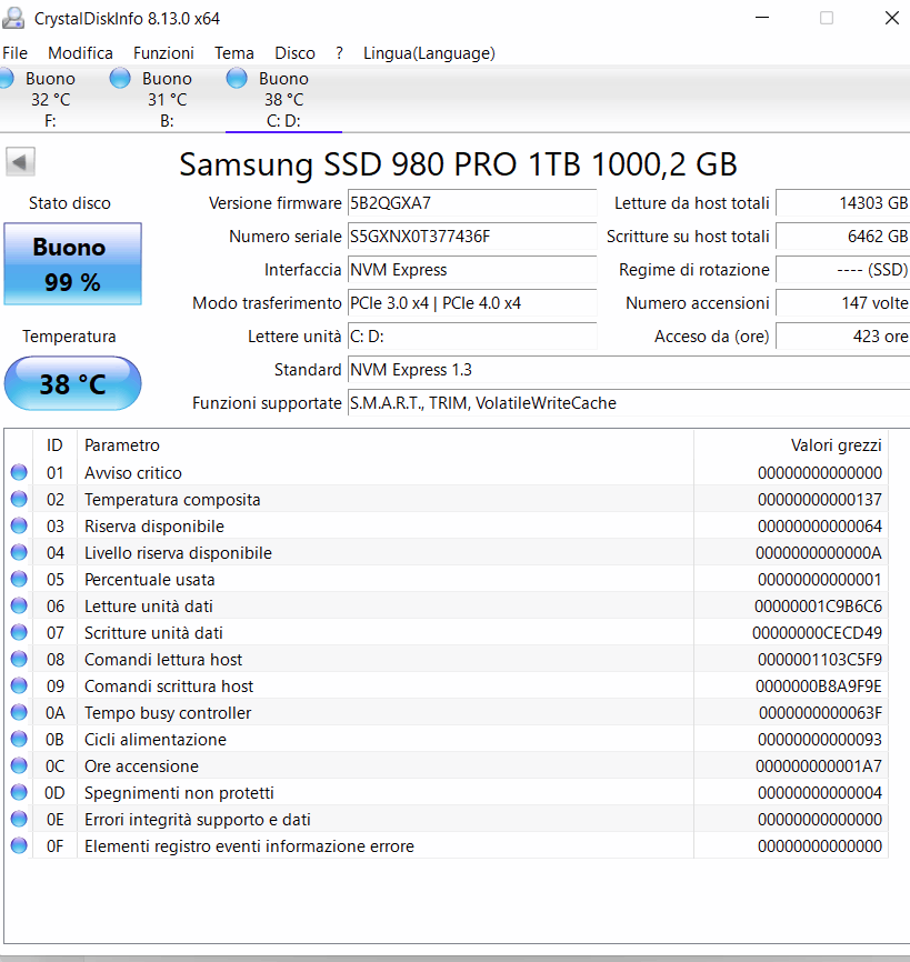

  2. Igor Leyko 112.4K Reputation points Independent Advisor
    2022-11-26T18:34:33+00:00
    Seems you have some problems with your SSD. If has one faulty sector already (see 05 attribute), and setupdiag says: Failure while adding the boot entry.
    Please check the drive with Samsung Magician tool. And please change B: disk letter to another one. A and B letters were reserved for a floppy disks historically, so some side effects are possible when you assign this letter to a hard drive.
    2022-11-26T17:41:34+00:00
    Hello Igor,
    here is setupdiag log
    https://easyupload.io/jb9ckv
    Drive Health is ok

  4. Igor Leyko 112.4K Reputation points Independent Advisor
    2022-11-26T17:18:38+00:00
    Hi Sasha,
    My name is Igor, I have 12 Microsoft MVP awards. It's a pleasure for me to help others and I'll do all my best to help you. I'm sorry you have a problems.
    You may use SetupDiag tool for detailed analysis of the problem.
    If it will be hard for you to interpret results, please share them to OneDrive, I'll look into them. https://docs.microsoft.com/en-us/windows/deploy...
    Check drive's health with CrystalDiskInfo tool and show its window.
