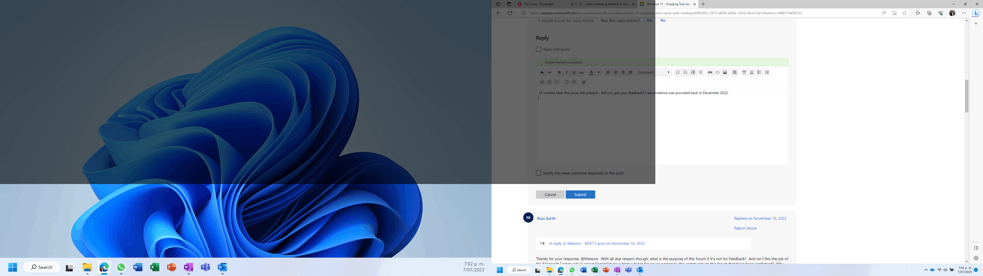

On Windows 11, if you have multiple monitors with different scale settings and resolutions, the snipping tool doesn't work properly. What happens is the smallest monitor's resolution determines what portion of the other monitors can be snipped. For example, I have three monitors on my Surface Laptop 4, the primary is 2496 x 1664 and is set to 150%. The second is 1920 x 1080 and at 100%. Third is 3440 x 1440 at 100%. When I hit print screen, it only greys out a portion of the first and third monitor. And the second isn't even greyed out at all. I've determined that if I put the all the monitors at the same scale, say 100%, the snipping tool works fine. It's only when one of them is different that the snipping tool doesn't work. Also, it doesn't matter if it's three monitors. This happens to me when I have only two monitors connected. I'm just using my current setup as an example.

I might have found a quick fix to this issue. I just 'repair' and 'reset' my 'Snipping Tool', and now it can screenshot the entire screen correctly.
Apps>Installed Apps>Snipping Tool
Under Reset, Use the 'Reset" and 'Repair'.
Hope it helps.

    I'm also having this same issue. Multiple displays (2) and when I open the snipping tool it does not cover the full screen. I have already set both my screens on the same scaling (100%) and use all recommended screen settings but his did not resolve the issue. Any other ideas? Please assist as my only work around is to drag document to be snipped to grey area and resize to fit this area. It worked perfectly in Windows 10??!!
