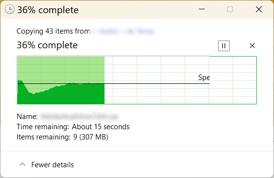

    Here is another example of a standard WIndows 11 dialog being broken by non-100% DPI.
    Can someone please confirm?
