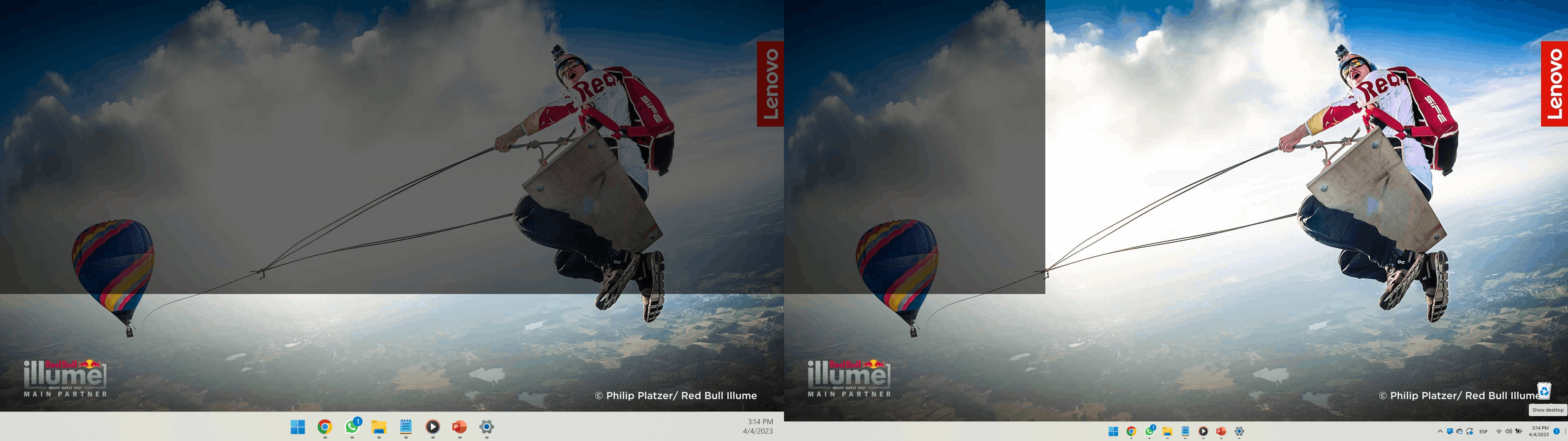

    Here's the screenshot you asked for:
    By the way, what someone suggested of changing the main display to the computer monitor did solve the problem. So this could work as a temporary fix.
