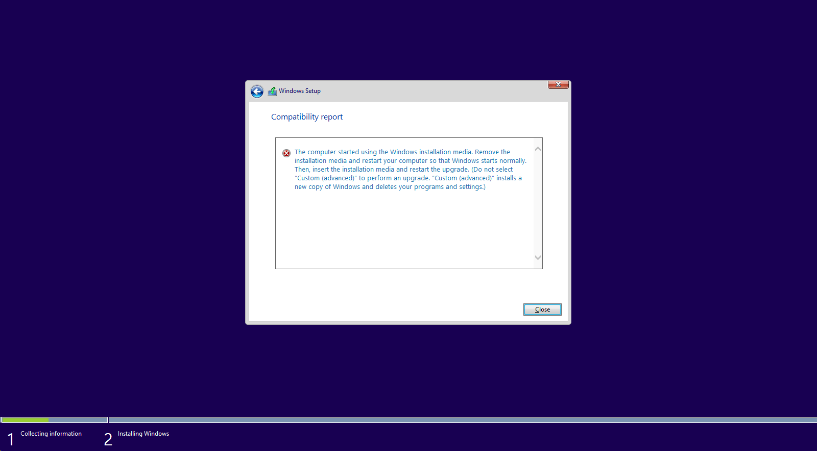

    Unfortunately I got a message like these when selecting the Upgrade option (screenshot found from the internet):
    Is there a workaround to force Windows to "Upgrade" my current installation without reinstalling Windows 10 and removing my applications and user data files?

    No, there isn't
    Perform a reinstall (steps in my previous reply)
    There are less chances of data loss, even with reinstall.
