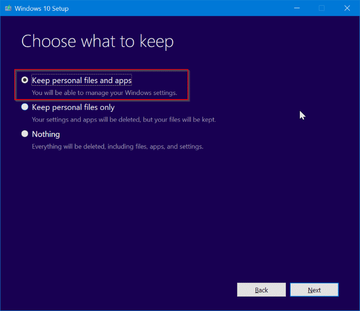

    May I ask, is it possible to run USB setup.exe inside WinRE to reinstall Windows 10 without removing programs? Example of what I mean (but it should be able to run inside WinRE):
    I'm waiting for your response.

    But it is okay if it is possible to run USB setup.exe inside WinRE to reinstall Windows 10 without removing programs.
    2021-10-04T12:55:40+00:00
    I don't think you can run apps inside WinRE, but you can try.
    Put the USB setup file into a USB drive, access cmd from Troubleshoot> Advanced options>command prompt; navigate to the usb directory and enter "setup.exe".
    If that doesn't work, a reinstall is the only option, unfortunately.
    Follow the steps I gave in my previous reply, after the backup.
    When you click OK for the warning (while installing), all your files are stored inside C:/Windows.old/users/username.
    When the installation is done, go to that directory and copy all the files there to your current desktop/downloads/etc.
