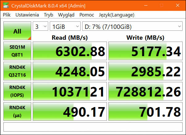

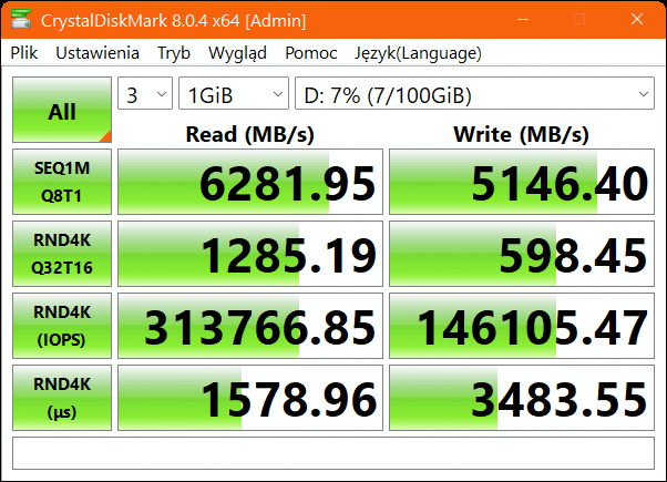

Windows 11 only has 45% of random write speed in Nvme SSD
2021-10-17T03:51:05+00:00
As you see above, the other performance is about the same, but in RND 4K Q32 T16 the speed has dropped significantly. I know that because the two software versions are different and the condition of the computer is different, it is normal for the performance to fluctuate, but this performance also dropped too much, and the performance remained stable low after many tests at different times.

    Hej, mam podobny problem z brakiem wydajności na dysku WD Black sn850, pod Windows 11 build 22000.778. Dysk nie osiąga pełnej prędkości, IOPS jest o ponad 50% niższy niż specyfikacja SSD wynosząca 100 000 IOPS. Problem nadal istnieje. Nie zrobiłem porównania pod Windows 10, od razu zrobiłem instalke na wygraną 11.
    Procesor AMD Razen 3700X, MB Asus x570 TUF Gaming Plus. Image
    Windows 11 in safe boot mode, IOPS values are much better, as declared by the manufacturer, I do not know what's going on!
