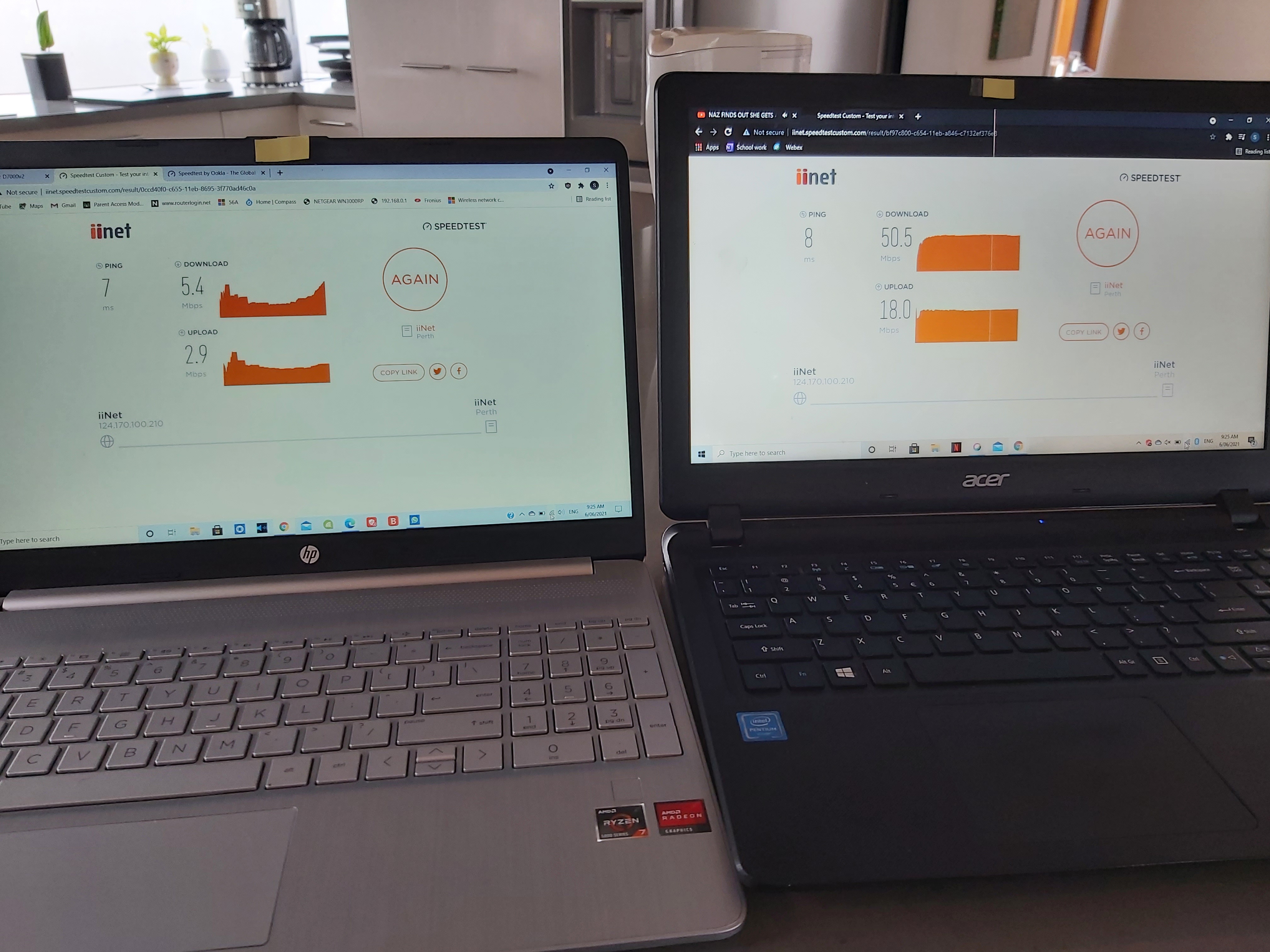

I need some real help as HP support doesn’t seem to know how to help and maybe it’s a windows problem.
I purchased an HP laptop 15s-eq2017AU about 2 weeks ago and I have wifi problems I cant fix.
 I am trying to keep it short. My internet disconnects or being connected without Internet etc. Sometimes it works well with normal speed, then all of a sudden I have a speed drop down to 4mbps/02mbps and shortly after I drop out of internet. Only my new laptop has this issue, all other devices, about 10, have no problems.
I have moved all my devices to 2.4Ghz except this laptop which is on 5Ghz. This made my laptop stable but I cannot connect to 2.4Ghz without problems.
Troubleshoot says various things like Wifi doesn’t have a valid IP configuration, network cable is not properly plugged in or may be broken, Problem with wireless adapter or access point or default gateway not available. Sometimes it fixes IP issue, sometimes it doesn’t. Troubleshoot will always reset my network driver. I did 2 network resets manually too without success.
Yesterday I did a troubleshoot and I had that blue screen: System Thread Exception not handled, what failed: rtwlane6.sys which is my network adapter I am pretty sure. After I restarted it was deactivated. Whats that about?
I tried static IP, DNS, uninstalled driver numerous times, Power is set to best performance, did the prompt commands reset, release, renew flush, ran the HP hardware diagnostics which all passed.

    First trial of today was still with my Netgear D7000 router.
    All devices were disconnected. With every new device I started a speed test in between, all on 2.4GHz.
    Start up with
    1. my laptop Download/upload        53/17
    2. Switch idle                                         52/17
    3. Xbox turned on
    4. Smart TV                                            50/16.8
    5. Lenovo laptop    Youtube               50/ 15.4
    6. Acer laptop Youtube                       30/17
    7. My Smartphone Youtube               25/10
    8. Netgear Extender                            drop, cant load any pages but Wifi icon still connected, secured. No drop out, speedest 6.77/0 or Latency test error
    9. Daughters phone connected, turned Acer Laptop off, meanwhile Fronius solar inverter connected. Speedtest 10/4.5; another test 20.2/6
    10. Xbox was on but no one played, now playing, 40/14.4
    11. Acer You tube turned off, Roblox started and daughter snapchat call Speedtest: 00/00 Ping 21
    5 minutes later disconnected, Troubleshoot: Plug in Ethernet cable.
    When I have no one else home and Extender is on with only few devices, it doesn’t compromise my laptops wifi. 2.4GHz is now unusable, constant drop outs or cant connect at all, meanwhile other devices are running fine.
    Next try iinet modem.
    I did screenshots of ipconfig /all when I was connected and when I was disconnected but I dont know if I expose my privacy when I post it here, probably?
    2021-06-06T05:04:56+00:00
    Last update for the day, I connected everything to my iinet modem which doesnt have the same good range or capacity like my nighthawk.
    I am not able to connect everything to one band without all devices suffering at least a bit. I had to move few to 5GHz.
    First, after starting one device at a time all seemed ok for about an hour or more. Speed was reduced and in all devices but not so bad like with nighthawk and my device still was always slower than the other devices. Downstairs, I had to connect few devices to my extender which is also not too great for gaming (my kids).
    Because everything was running ok with all devices for quiet some time, I assume that there is no interference from another device, would you agree or am I ignorant again? ;)
    Just then I dropped out of both bands. Online right now but speedtest wont even run. So definitely worse.
    HP is elevating to the concerned team. Will see what they come up with. As recommended by you, I hope I can convince them to get a different adapter. I like that laptop otherwise. If not, money back but I might be dreaming here as they already offered it with the first one. Should have gone right away to a different model or brand but I did not think its a make issue.
