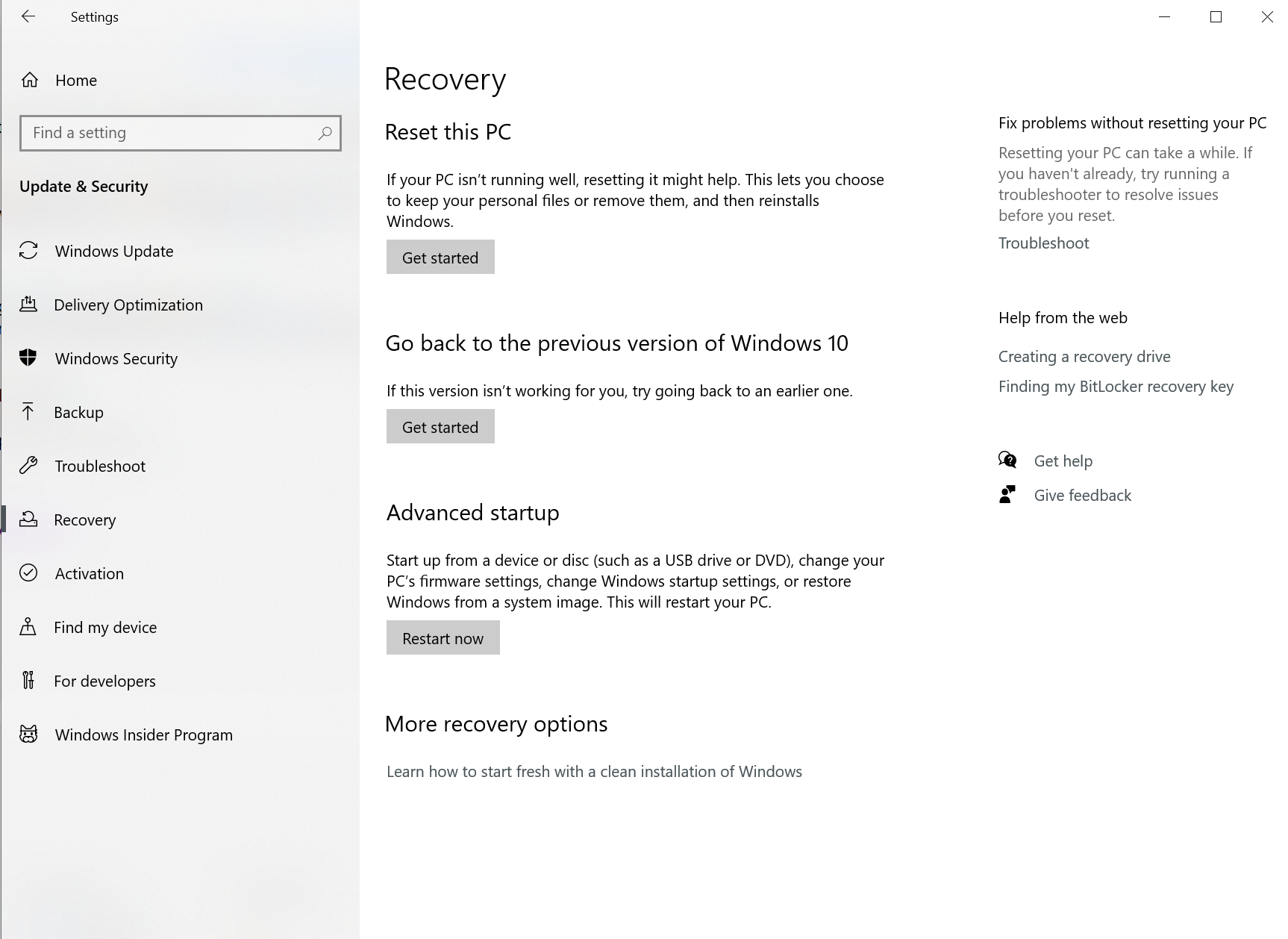

    2020-12-28T10:44:03+00:00
    I can't seem to find "Refresh your PC without affecting your files" in my settings panel. I've attached a screenshot of my options.
