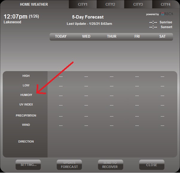

Thanks to this community, I have found the software for the Sharper Image EC-WS115, and I've learned how to deal with its USB issues under Windows 10.
But, it stopped updating the forecast on November 30th, 2020.
The 5-day forecast software gives me an error saying "Cannot connect to server. Please try again later" whenever I try to update the forecast.
Is anyone else having this issue, or just me? Has Foreca shut down the server used to feed information to these devices?
