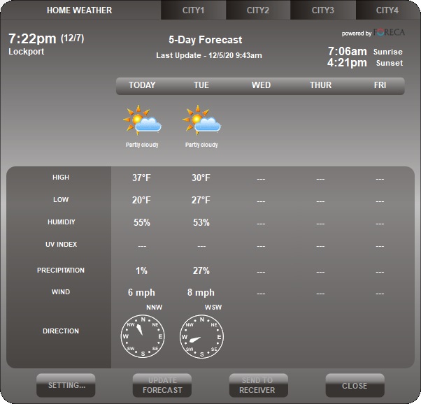

Thanks to this community, I have found the software for the Sharper Image EC-WS115, and I've learned how to deal with its USB issues under Windows 10.
But, it stopped updating the forecast on November 30th, 2020.
The 5-day forecast software gives me an error saying "Cannot connect to server. Please try again later" whenever I try to update the forecast.
Is anyone else having this issue, or just me? Has Foreca shut down the server used to feed information to these devices?
I don't want to send this device to a landfill.

    I  also have the Sharper Image EC-WS115 and the last forecast update was 12/4/2020.  I am also getting the "Cannot connect to server. Please try again error message"    This has happen before a couple times with the EC-WS115.  Maybe about a year ago.   More than likely the weather forecast provider (Foreca) is changing servers.  Last time this happen it was about a week before it was back to normal.
