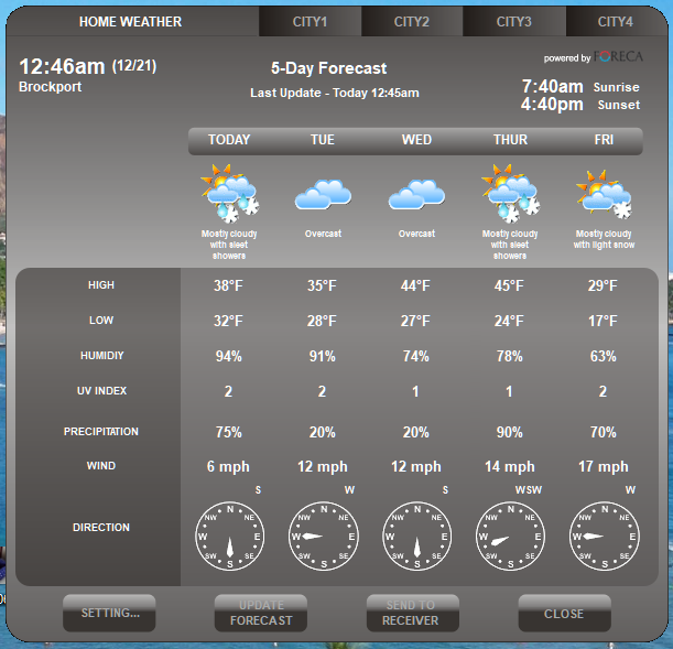

    Open the "5-day forecast.exe" file in the "5-Day Forecast" folder using Notepad.  Do a search on the text string "humid" and you'll clearly find the ill-spelled "HUMIDIY" entry (see below)
    NOW, how in the world you're gonna change it is beyond me.  I tried to do a "SAVE AS" under a different name, so as not to destroy the original, but could not do so within the same directory.  I saved it elsewhere but could not execute it from the other directory.  I subsequently created a backup copy within the the original folder, but the system would not allow me to save the changed original (access denied).
    Methinks you're gonna have to live with the anomaly.

    While we’re debugging this antique, does anyone know how to fix the screen so that humidity isn’t misspelled? It has always bothered me, as mine shows ‘humidty’, or something like that. If anyone has any ideas, please share. Thanks!
