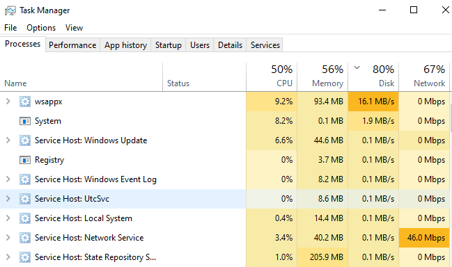

    Why choose Sunday Microsoft, should you not be at Church? Hold on a minute, the DEVIL would not go to Church!. I occasionally see wsappx running but for short periods - running process being waasmedic agent for the 6 minute odd Sunday Run. Just seen Barsey's posting after composing this. There have been rumours about for a while, that new computers with Windows 11 pre-installed will be on a subscription basis. Once they have you, they can then up the price as and when they wish. Who would then buy a computer with Windows 11, have MS not thought this through?
