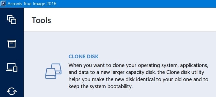

Something I’ve always done over the years is run weekly 100% mirror image bootable backup clones of the C-drive in my ThinkPad laptops…using spare USB cable connected SSD hard drives.  [ connect the drive, run ‘Acronis True Image’ cloning software that I use, done ]

But discovered a pesky little problem as I’ve been setting up a new ThinkPad P52 to replace my older P51.  After I finished setting up the new P52 C-drive, I cloned it to a USB attached hard drive like I’ve done on the P51 a couple hundred times…and then just to be sure it worked, tried to boot the P52 back from the cloned USB attached drive.

My cloning software works like always because I’ve taken cloned copies and physically installed them inside the laptop as the internal C-drive and the laptop comes right up normally / works perfectly, etc.  I simply cannot BOOT FROM a USB connected clone any longer.

    I also use Acronis, but I do not even know if mine will Clone.. I have always saved my backups as images instead..

    Here is what I found out.. My TrueImage does in fact Clone. It turns out to be far to slow to deal with at the moment so I used pre-existing images I had saved.. I tried both Windows 10 and Windows 7.. Both failed to boot from SSD in a USB enclosure.. They both tried but failed right after the Windows Logo screen..
