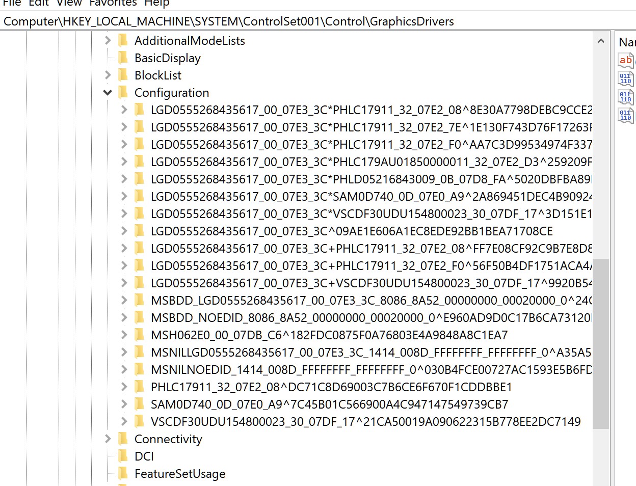

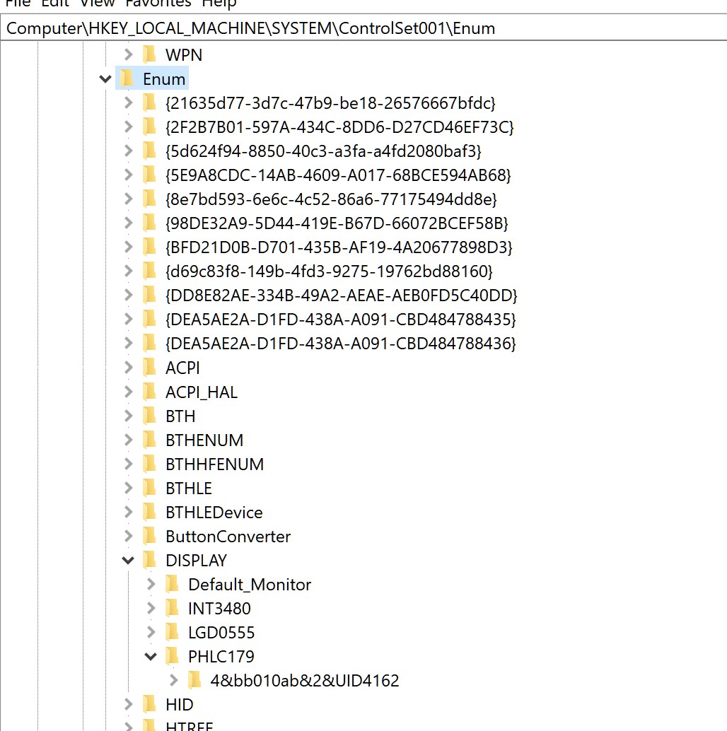

I accidentally clicked the 3d display mode toggle button in the display settings window while my 3dtv was set to a resolution that Windows considers unsupported for 3d. Instead of simply reporting to me that the display mode wasn't compatible, or reverting the option to 'off,' the system cycled display modes a number of times before stopping the driver for my video card.
Once the video card driver was stopped, windows reverted to its default video driver which would not allow any change to the display resolution and did not allow disabling the "3d display mode" option.  Restarting the video driver (by disabling, then re-enabling the video card in device manager) resulted in the computer immediately cycling display modes again and stopping the video driver again. There was no way to interact with the display settings windows during the brief period the video driver was running. Restarting the computer was obviously no help,  The problematic setting was set and Windows was not going to unset it.
Switching to a non-3D display allowed the video driver to be started and remain active, but as soon as the 3dtv was selected as a display, the computer attempted to go to 3d display mode at the unsupported resolution again and failed in the same manner.
I tried completely uninstalling & reinstalling the video card's drivers and uninstalling & disconnecting display devices. I tried to find any way to change the 3d display mode setting manually (e.g. in regedit)
I tried doing a system restore (system restore failed for no apparent reason despite trying multiple restore points, perhaps due to a recent Windows feature update that didn't save a restore point after completing).
**NOTE: Don't delete or change registry entries unless you know exactly what you are doing or are prepared to lose everything and do a clean install of Windows**

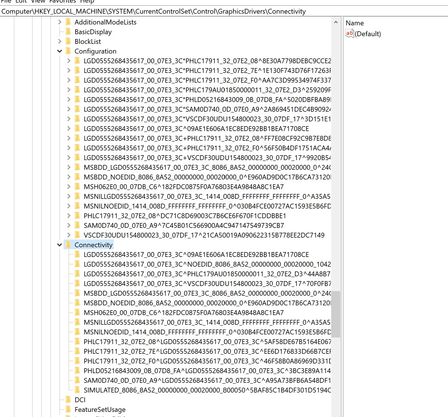

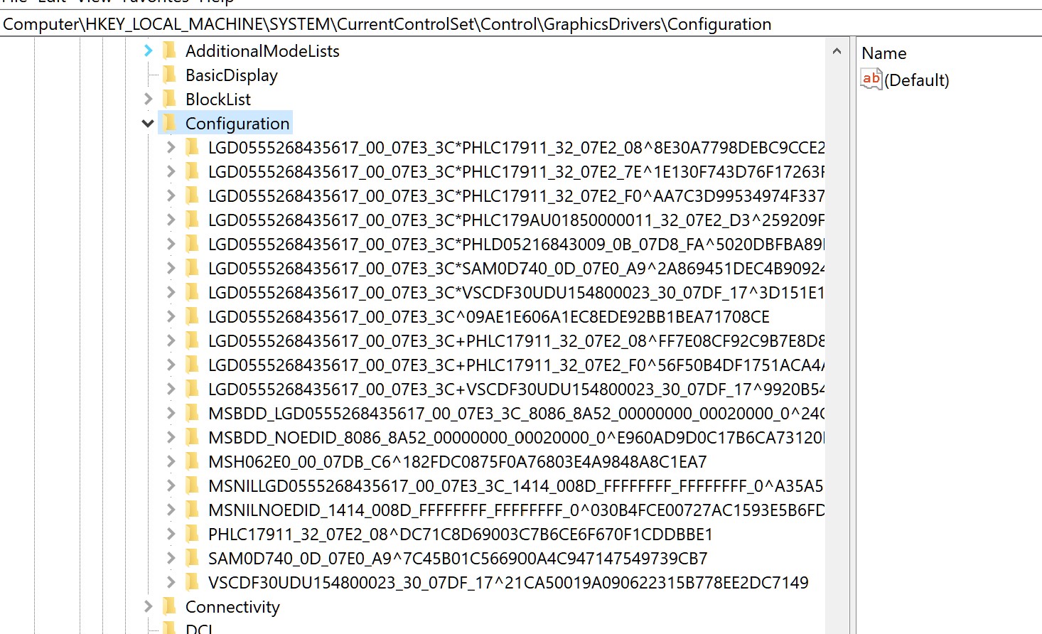

I tried deleting anything pertaining to the video display mode settings in HKLM\System\CurrentControlSet\GraphicsDrivers (\Configuration in particular)
Nothing worked to clear the 3d display mode setting and each time I set windows to use the 3dtv as a display, it tried to revert to the incompatible mode and stopped the video driver.
The solution:
**NOTE: Don't delete or change registry entries unless you know exactly what you are doing or are prepared to lose everything and do a clean install of Windows. The following solution could try to force a display into an unsupported display mode.  I believe all displays will cope with this, but there is a tiny possibility that this could ultimately damage a display device.  EDIT: TRY CK88's APPROACH IN THE REPLIES TO THIS POST BEFORE TRYING THIS ONE**
Ultimately, the only thing I was able to do that worked, was to copy display mode settings in the above registry key from a different display set at a different resolution (one that supported 3d display mode on the 3dtv) to overwrite the appropriate registry values for the 3dtv. It may be difficult to ascertain which are the correct registry keys to use if you've had a number of displays and display modes set up on your PC and haven't already cleared out the Configuration key out of desperation. This also relies on you having another available display device that features a resolution that is both a Windows-supported 3d resolution on the 3d display device and has sufficiently similar specific settings (e.g. stride, video standard, Hsyncfreq.Num/Denom, pixelformat, pixelrate) for the edited display mode to function correctly on the 3d display.
Once this was done, the computer was restarted, the 3d mode enabled correctly and I was then able to turn off 3d mode, and choose my preferred resolution again.
