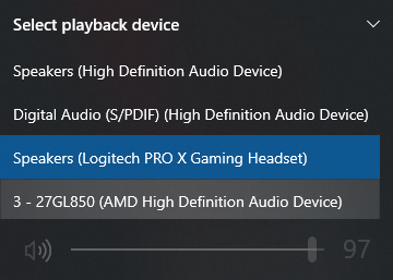

    I am having the same issues with both my RX5700XT and RX580. ANY games would crash within minutes, sometimes up to 30 minutes if it was a low-end game. I have also changed registry, bought a new GPU, PSU, uninstalled/reinstalled windows, full-wiped drives and installed windows, and more. What did help me was uninstalling the AMD High Definition Audio Device. I think it uses the monitor speakers, or at least sends the audio over to the monitor. So as long as you have speakers/headset plugged into the motherboard or soundcard, uninstalling the AMD Audio driver should not affect your sound.
    To uninstall, go to Device Manager --> Sound, video and game controllers. The AMD HD Audio Device will reinstall when you update windows or amd drivers.
    I do still sometimes get crashes, usually when first setting up a game, or changing settings sometimes. Sometimes when opening another program, like if I was playing without Chrome open and then opening Chrome, it will crash but only sometimes. The crashes have been reduced significantly though, if went from not even being able to leave the title screen without a crash for newer AAA titles to hours of crash free gameplay. I have played AC: Valhalla with chrome and discord open for a 7 hour session and did not experience a crash. I do crash a lot in BO Cold War, but I think that might be a Cold War issue since it is not affecting other games for me.
