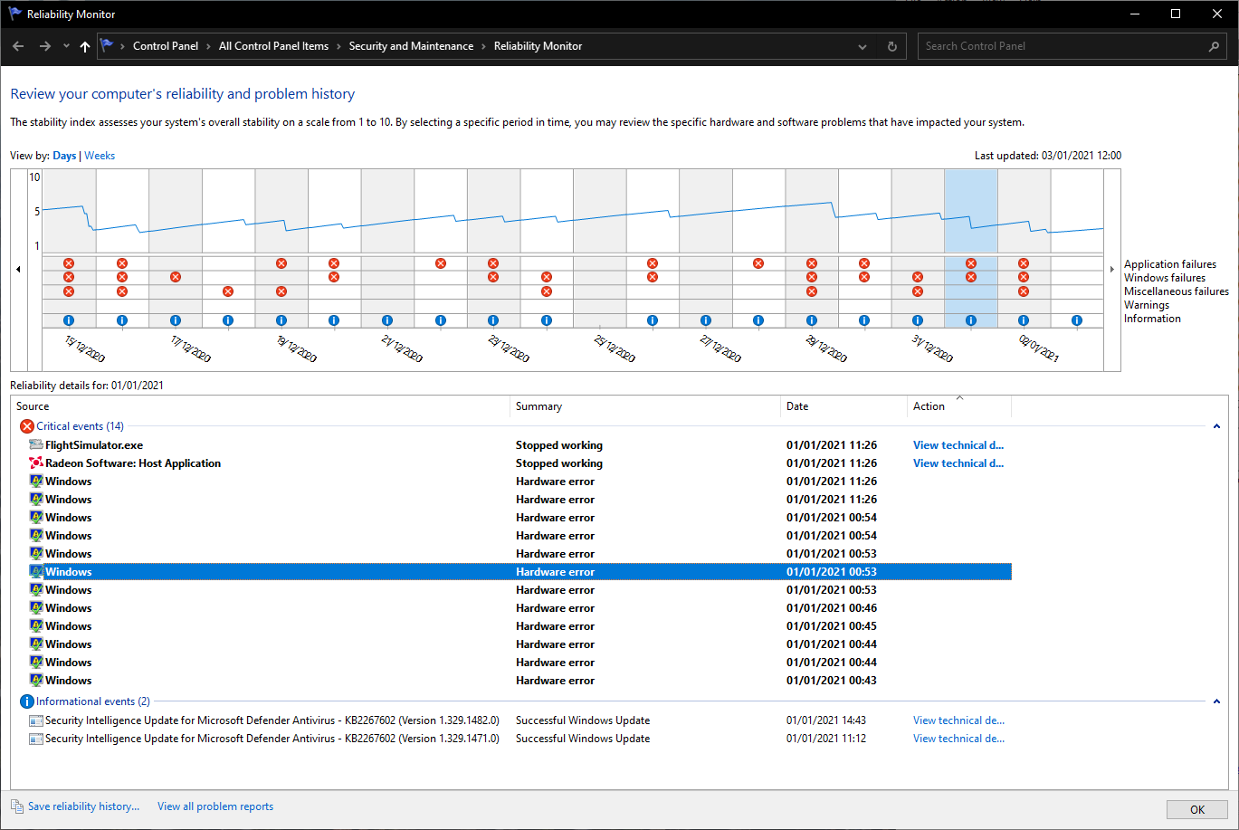

    I get the same "amdkmdag stopped" error. Also if you open reliability monitor do you have red "X" symbols and Windows "Kernel Error" events that correspond to the crashes?
