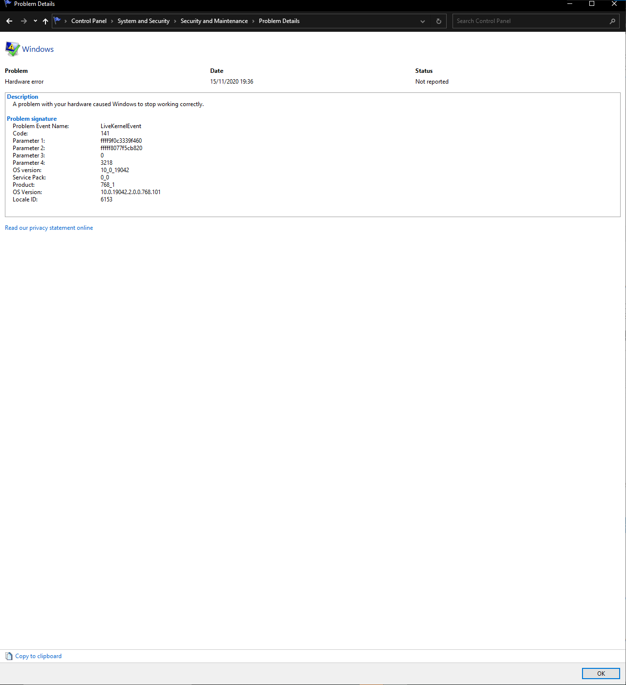

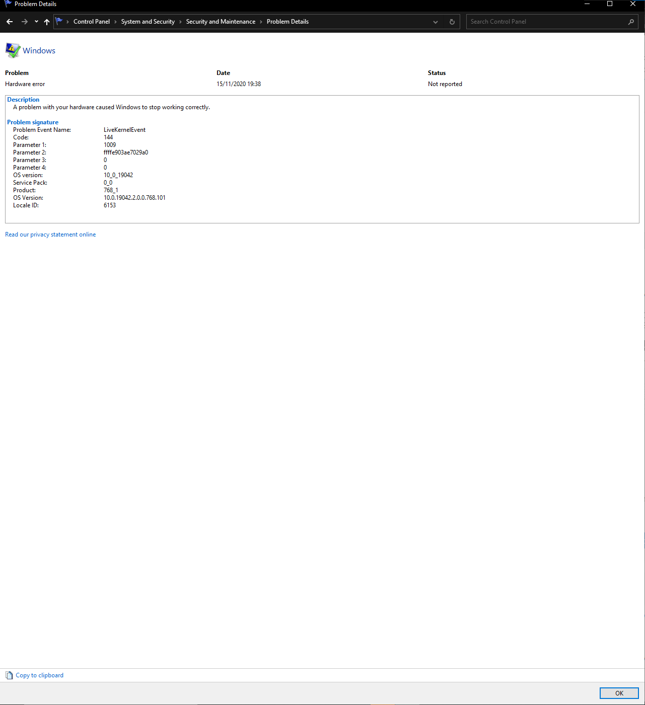

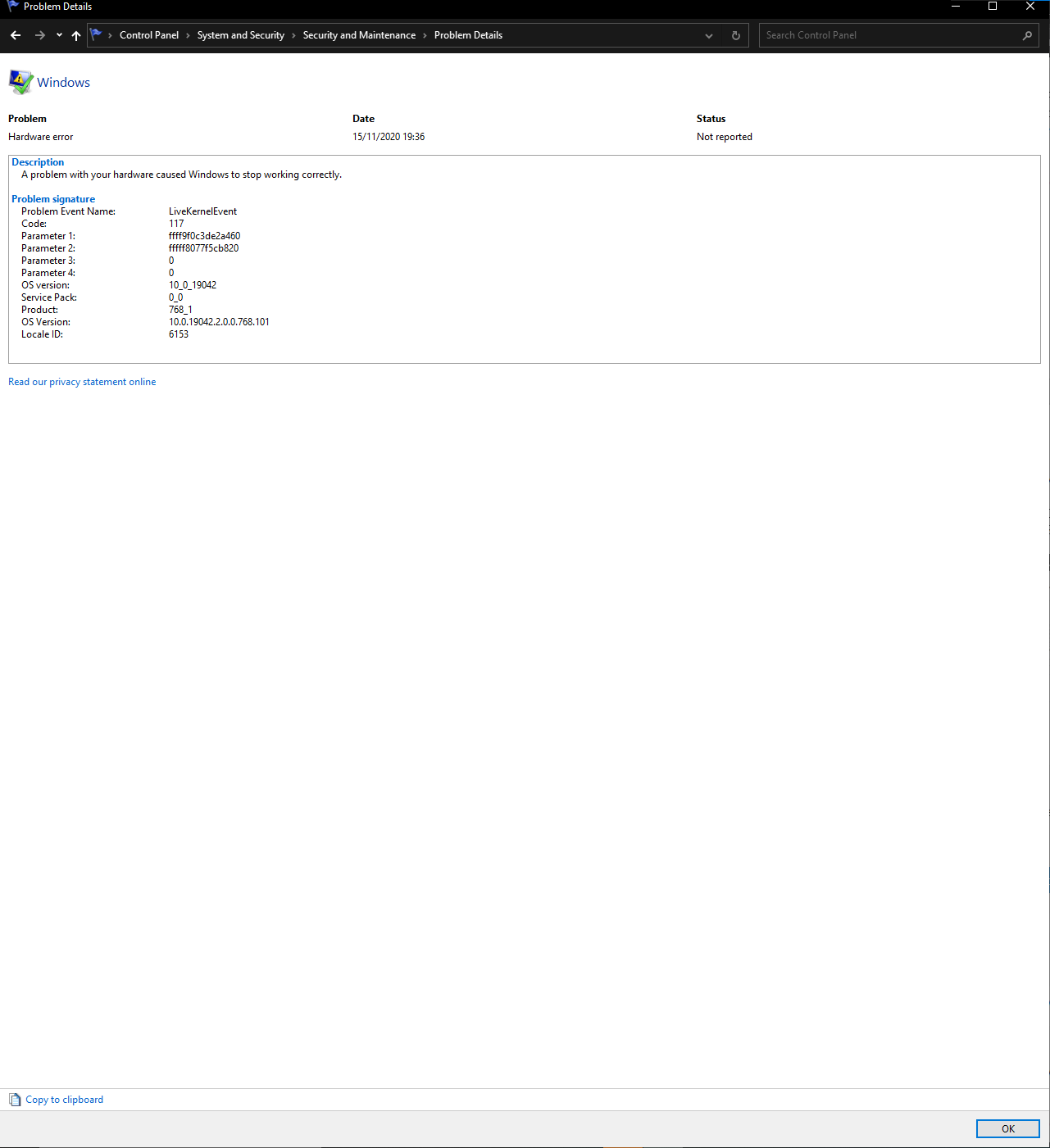

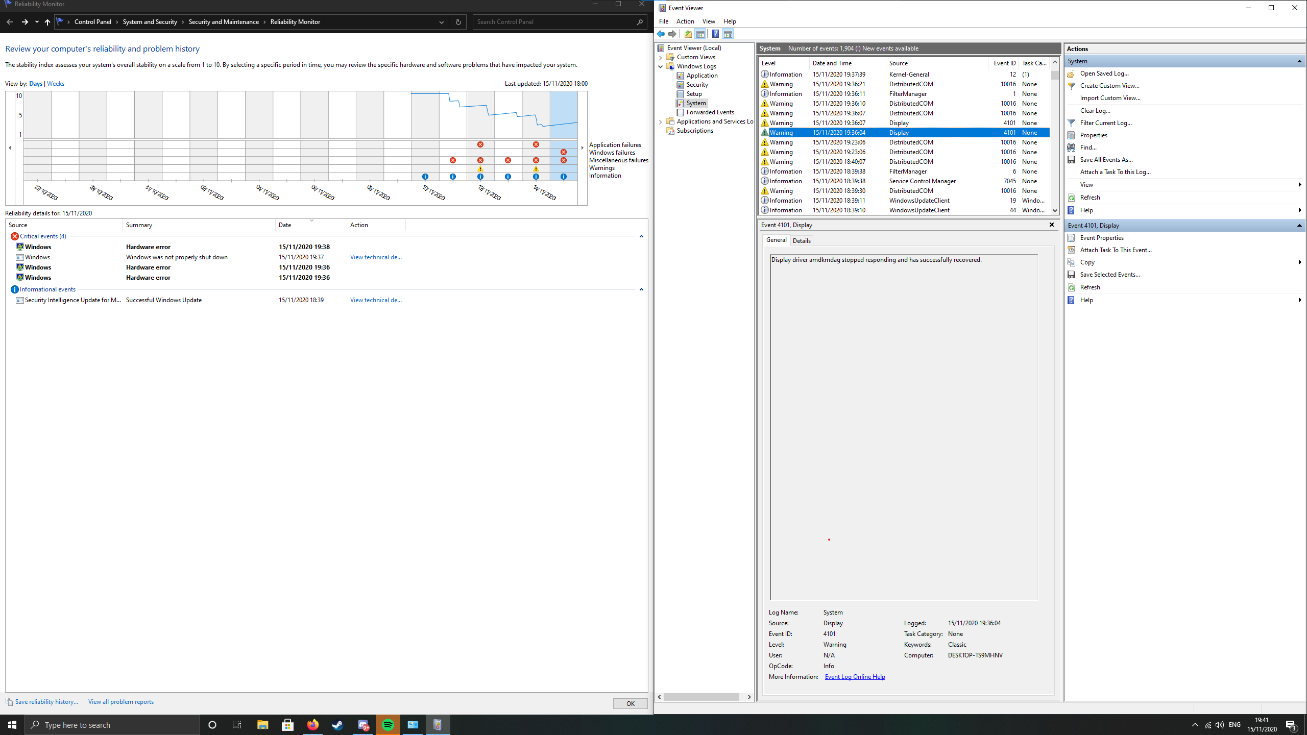

    Hi Gregg, just want to let you know I have a 5600 XT and have been having the same problem. I see LiveKernelEvent 117 and 141, then LiveKernelEvent 144 in logs for the reboot after the crash. I tried DDU, and even reinstalled Windows a few days ago, but the issue persists.
    Built the system in May, and had a crash here and there, but the crashes went from less than one a week to daily around the end of September or beginning of October. This coincided with a Windows, AMD, and GPU VBIOS update (via MSI Dragon Center).
    These updates caused image artefacts, followed by a crash to desktop. Usually a full system crash happended shortly after, or I had to force a reset since the system was frozen. Flashing the 2020-03-09 VBIOS on this page seems to stop the image flickering/corruption but I still get occasional crash.
    My system also reports unexpected shutdown almost everyday despite the fact I shutdown using the Start menu as you should...
    What's interesting is that they seem to almost exclusively happen in PUBG and Borderlands 3. I don't think I've had a single crash in the Witcher 3 or Stardew Valley.
