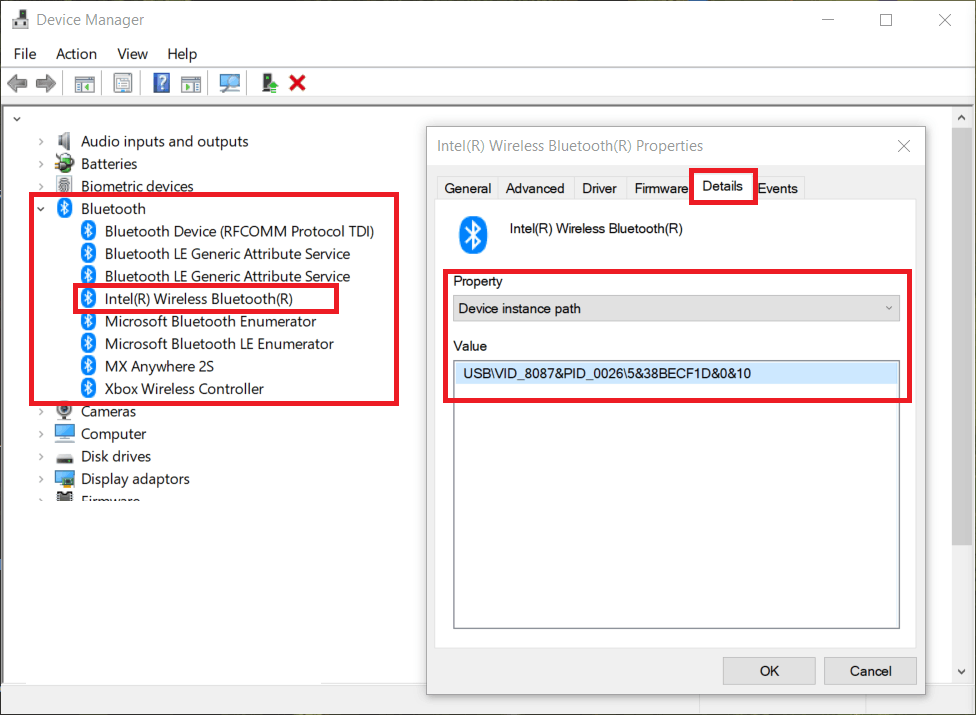

DISABLE BLUETOOTH POWER SAVE
Press Windows + X and select Device Manager
There you will find the Bluetooth adapter
Right click the adapter and select Properties
Uncheck "Allow computer to turn off this device to save power"
Click Ok

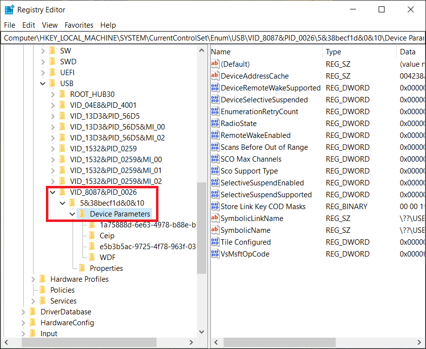

MOUSE REGISTRY HACK
Add the following keys at this location: Computer\HKEY_LOCAL_MACHINE\SYSTEM\CurrentControlSet\Enum\USB\VID_8087&PID_0026\5&2816b067&0&10\Device Parameters
"DeviceSelectiveSuspended"=dword:00000000
"SelectiveSuspendEnabled"=dword:00000000
"SelectiveSuspendSupported"=dword:00000000
