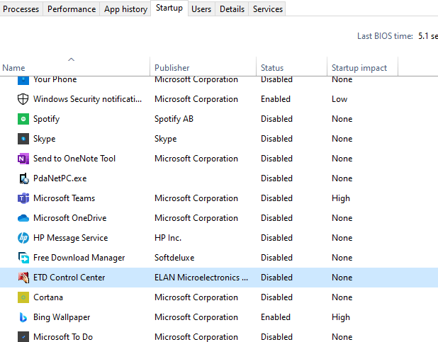

    Wait a second because I changed the ELAN touchpad drivers to Windows precision touchpad using an unofficial method using this link given here-- https://www.windowscentral.com/how-enable-precision-touchpad-drivers
    I did this cause I felt this precision drivers are more responsive and easy to work with Touchpad after I installed I used to get blue screen of death at every startup(What failed on BSOD showed ETD.sys) after installing and I fixed it by stopping elan service and ELAN startup service like this
    But the thing is, the issue which I am facing is not after installing this but long before I even knew about this precision driver. So i don't think ETD.sys is causing Black screen. Because this issue was present even after Factory reset.

    >Regarding the dump files. I know that the files are of today and I am facing the issue its not fixed yet but what I am trying to say is ETD.sys is showing because I don't have official HP provided ELAN touchpad driver as ETD is ELAN touch driver and I've changed the driver to another ELAN unofficial driver which enabled Windows precision touchpad drivers(I gave above link from where I downlded). I still have the Unofficial ELAN drivers and this BlkSOD issue is been since I purchased this laptop 2 yrs ago, even when I had the official ELAN drivers from HP. I've tried restoring the official ELAN drivers and no change.
    I'll install official ELAN drivers and then give you the dump files again may be then the main reason will show up.
