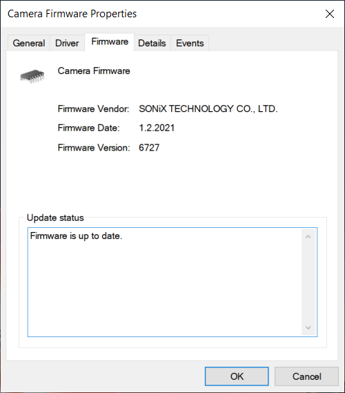

    That's right, after turning off bitlocker and restarting, the firmware update was able to finish.
    However, Windows Hello Face still does not start but gives the same error message as before "We couldn't find a camera compatible with Windows Hello Face". I believe that is because of the missing item with "Hello" in its name from Device Manager, because when I uninstalled that according to the instruction given in another message thread in this forum, that error message started to appear. Bummer I can't recall the item's entire name but I think it was listed under Biometric devices. I believe I still have a backup image from the time before the uninstallation. Do you think it would make sense to restore to that image and take some files from there? If so, what exactly should I do when I am there in order for the visit to be useful? I cannot stay there for long as I need the installations made and other data saved after that date.
