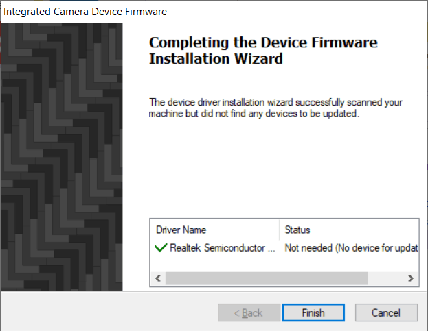

    I did not because it says Realtek and I believe the camera in my laptop is Sonix, so I thought the driver would not be compatible with my hardware. I believe my camera is Sonix because during the support case with Lenovo, the Lenovo support guy talked about a Sonix driver for the camera. Anyway the camera in my laptop is the one that was originally installed in it when I bought it, is there a way to check what model it is without opening the laptop case? Anyway now I tried installing this Realtek driver and its installation said:
    I think that's good because installing a driver of a wrong model would probably have caused even more problems.
  3. Virginia M 42,075 Reputation points Independent Advisor
    2023-03-17T19:14:38+00:00
    Your original screenshot suggests that you’re not signed in with an administrator account but a user account. Would this be the case?
    The camera drivers refer to Sonix also:
    10.0.22000.20261(Realtek) / 10.13.19041.28(Sonix) / 5.0.18.168(Sunplus)
    Both camera drivers shown mention this so if the first doesn’t install then please try the next.
    Integrated Camera Driver for Windows 11 (Version 21H2 or later), 10 (Version 1809 or Later) - ThinkPad Or Integrated Camera Driver.
    2023-03-17T20:57:12+00:00
    Yes I usually use a non-admin account for security reasons but now I have signed in with the administrator account whenever needed to do your suggestions. Regarding the message that appears during the firmware installation (the screenshot I posted above), it did not say there were not enough privileges but no device to be updated was found. I now tried and the exact same message appears if I try to install the firmware while signed in as administrator.
