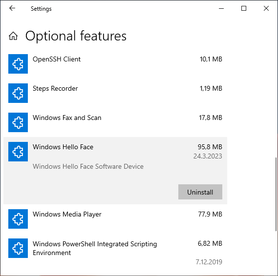

When I uninstall it and restart the computer, it appears back with the same error. But as said previously, I don't think it is related to this problem (to be exact, it may also be causing a problem but it is not the original problem). Please remember that every other application on this laptop using the camera works just fine and has no issues using the camera. I think that item appeared in the Device Manager when the Lenovo support guy told me to install every optional update found in Windows Update. I think doing so was a mistake but regardless it is not the original problem. I still wonder where I could get the "Hello" item back to my Device Manager, that's what changed when the Windows Hello Face setup stopped starting. Is anyone else having an item in Device Manager with the word "Hello" in its name?
We couldn't find a camera compatible with Windows Hello Face
I have a Lenovo ThinkPad T15g Gen 1 running Windows 10 Pro 22H2 64-bit. I am having trouble trying to setup Windows Hello Face.
The initial problem was that the setup proceeded all the way to the phase where it showed my face and was supposed to recognize it, but then nothing happened and the only option available was to cancel the setup. In order to solve that issue I did according to the instructions here https://answers.microsoft.com/en-us/windows/forum/windows_10-hello/facial-recognition-not-working-for-windows-10/0253a932-4313-4536-858d-abebb50bfad9 i.e. removed the camera drivers ("Integrated Camera" and "Integrated IR Camera") and one driver with "Hello" in its name (can't recall the exact name anymore) from Device Manager. The camera drivers appeared back automatically but the Hello driver does not even if I scan for hardware changes.
Now after doing that the Windows Hello Setup does not even start but shows the error message "We couldn't find a camera compatible with Windows Hello Face" (see the screenshot). I contacted Lenovo support and they say the camera is compatible (after all, it showed the video in the setup before I removed the drivers), also the camera cannot be physically broken because no other application has any problems using it. Lenovo's solution would have been to reimage the whole computer, which I obviously cannot do because I have all my vital work related stuff installed in it.
So I'm quite stuck now and afraid to try things arbitrarily as my earlier attempt to do so only made the situation worse. My own guess is this has something to do with the drivers but I don't know where to get drivers that are definitely compatible with my device and will make this work. Help from anyone who understands how this thing works will be highly appreciated. Thank you.
