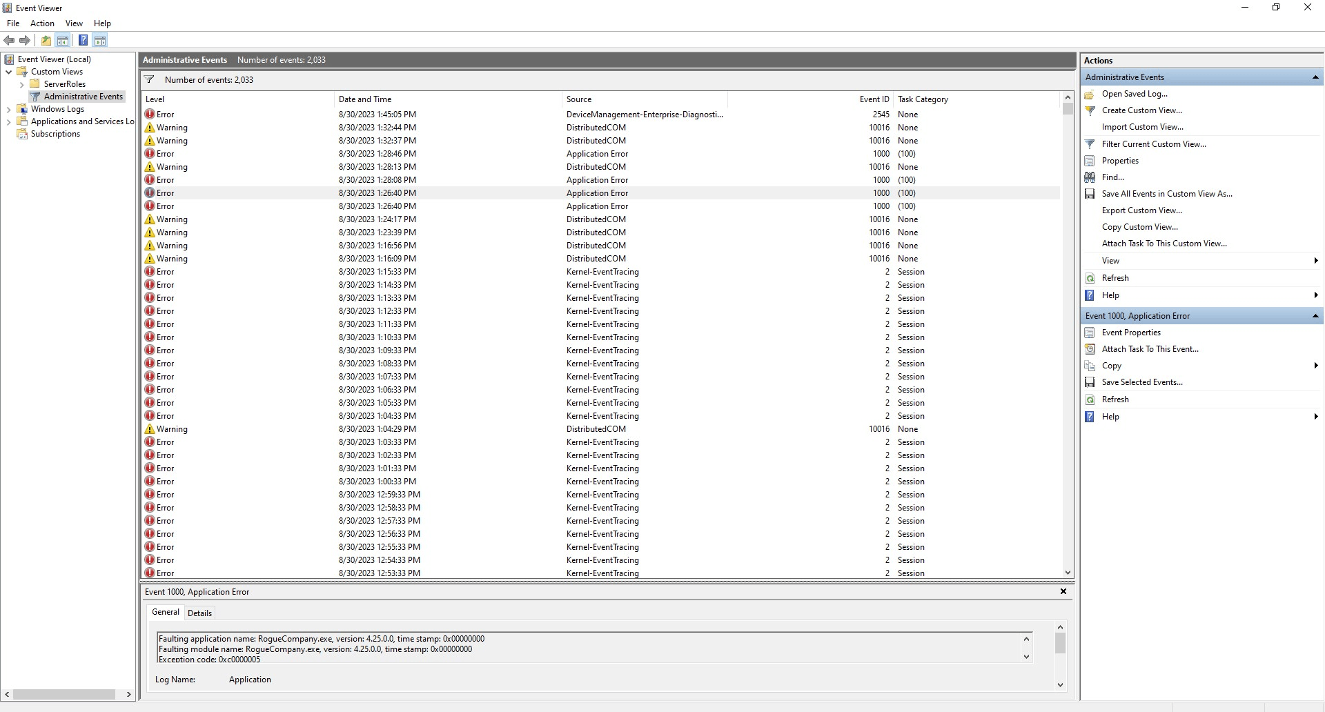

    I would take all the help there is, I've been having this issue for the past 2 years and it's driven me insane I tried troubleshooting on my own and went down a rabbit hole understanding CA and the errors on event viewer and even using chat gpt to resolve this but no joy, any best reccomendation or updates on this? thanks
