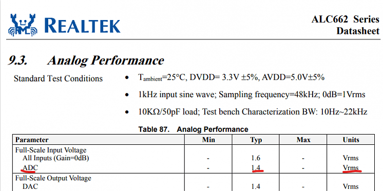

    If you people want to set your gain structure correctly, then try this if you are using a 3.5mm headset on a realtek chipset. Setting the mic volume to 100 is incorrect.
    First, go and watch a few gain staging videos on youtube.
    Right mouse click to get to dB. Microphone Boost is your mic pre-amp. The top mic volume is your fader, usually 50 is your 0 dB (mine is at 47).
    Realtek audio chipsets usually have a 13-14 dB headroom, so if you are using a 3.5mm mic on your computer, set your mic to be around -13/-14 dBFS on your DAW. 1.4 volt is 2.92 dBV. The standard operating level for consumer electronics is -10 dBV. Therefore a Realtek audio chipset will give you 13 dB of headroom (from -10 dBV to +2.92 dBV).
    So speaking normally in a DAW and you should aim for -13 dBFS in the signal meter by changing your mic boost and the fader.
    This is the correct gain structure for you microphone. Only after you adjust to the correct gain structure then you can disable automatic mic gain control. The volume of your microphone audio playback is a different matter.
