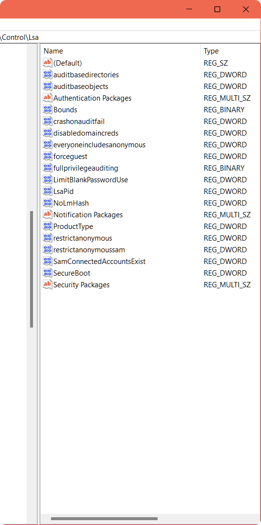

    I DONT HAVE RunAsPPL value in the right pane. HELP. MY PC IS UNDER ATTACK BECAUSE MICROSOFT CANT DO ITS JOB RIGHT. AND IS JUJST ROBBING ME THE LAST 4 YEARS

    1. Open Windows Registry Editor.
    2. Navigate to the following location: Computer\HKEY_LOCAL_MACHINE\SYSTEM\CurrentControlSet\Control\Lsa
    3. Make sure you have RunAsPPL and RunAsPPLBoot. entries. If you don’t have RunAsPPLBoot listed, create DWORD entries for RunAsPPL and RunAsPPLBoot.
    4. Value for both entries should be 2.
    5. Reboot and warnings should stop.
    If you prefer not to (or cannot) edit the Registry, this web page also has a simple Powershell script you can copy and paste in Powershell to make the settings:
    https://www.windowslatest.com/2023/03/18/windows-11-incorrectly-warns-local-security-authority-protection-is-off/
    Looks like adding the two entries with a hex value of 2 did the trick; the warning triangle in the Windows Security taskbar icon is gone. Thank you!!
