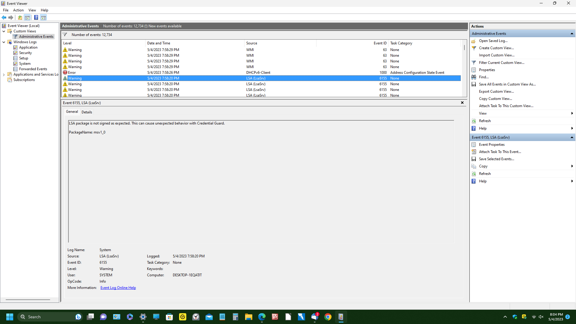

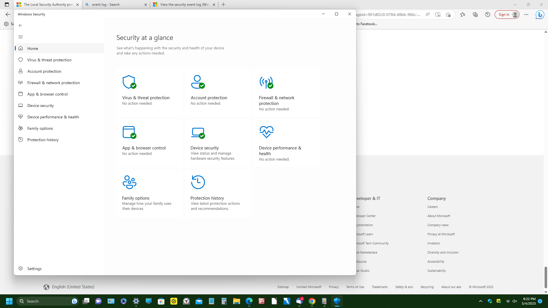

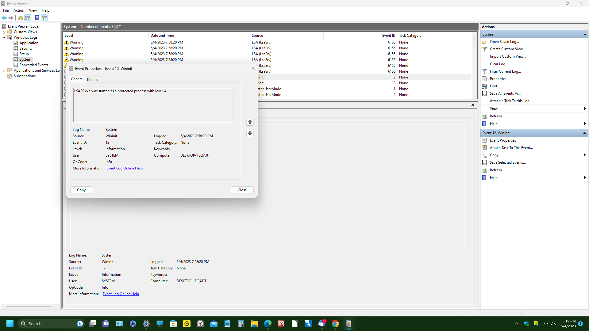

    Well I updated just now and this is what I have now
    Edition Windows 11 Home
    Version 22H2
    Installed on ‎10/‎15/‎2022
    OS build 22621.1635
    Experience Windows Feature Experience Pack 1000.22641.1000.0
    And this is what event viewer says
    But it still says this:
    Am I good for now? Is this WORKING? I have the green check mark
