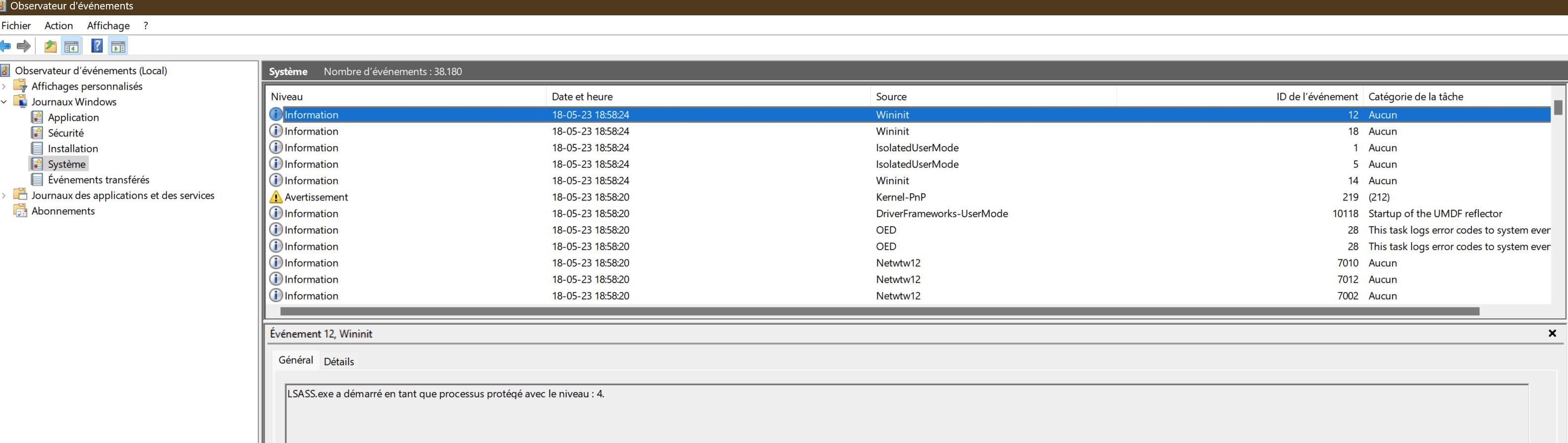

    After that you will see a value of 12 for Wininit.
    To activate LSA, Windows advises to do this if not active but not to do any other form of workaround, I specify that I did not risk giving a value of 1 ( with UEFI variable ) as I found that this is already enough complicated for me.

    Hello RicardoCasini,
    LSASrv is something else: you have to look for Wininit which must have a value of 12 as in the screenshot below ( see the photo, sorry if it is in French) , You have an interesting link here ->
    https://learn.microsoft.com/en-us/windows/release-health/status-windows-11-22h2?utm_source=pocket_saves#3048msgdesc
