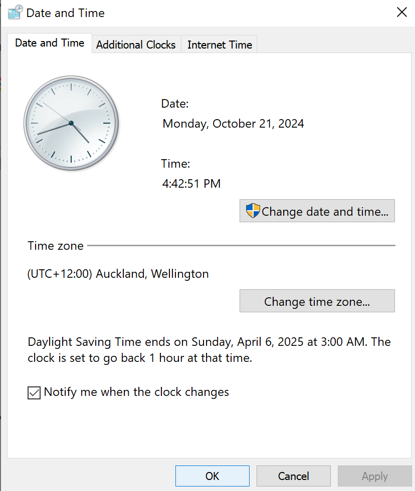

2023-10-07T19:45:01+00:00
I had this same issue, but found a workaround (At least a temporary one)
Right click the date/time toolbar in the bottom right corner, then click "Adjust date/time" from the menu.
In that menu, scroll down to "related settings" and click "Add clocks for different time zones"
This SHOULD bring up a classic windows menu. Click the far left tab for "Date and Time" and select your time zone there. Click "Okay" and then "Apply" and you should be good to go.

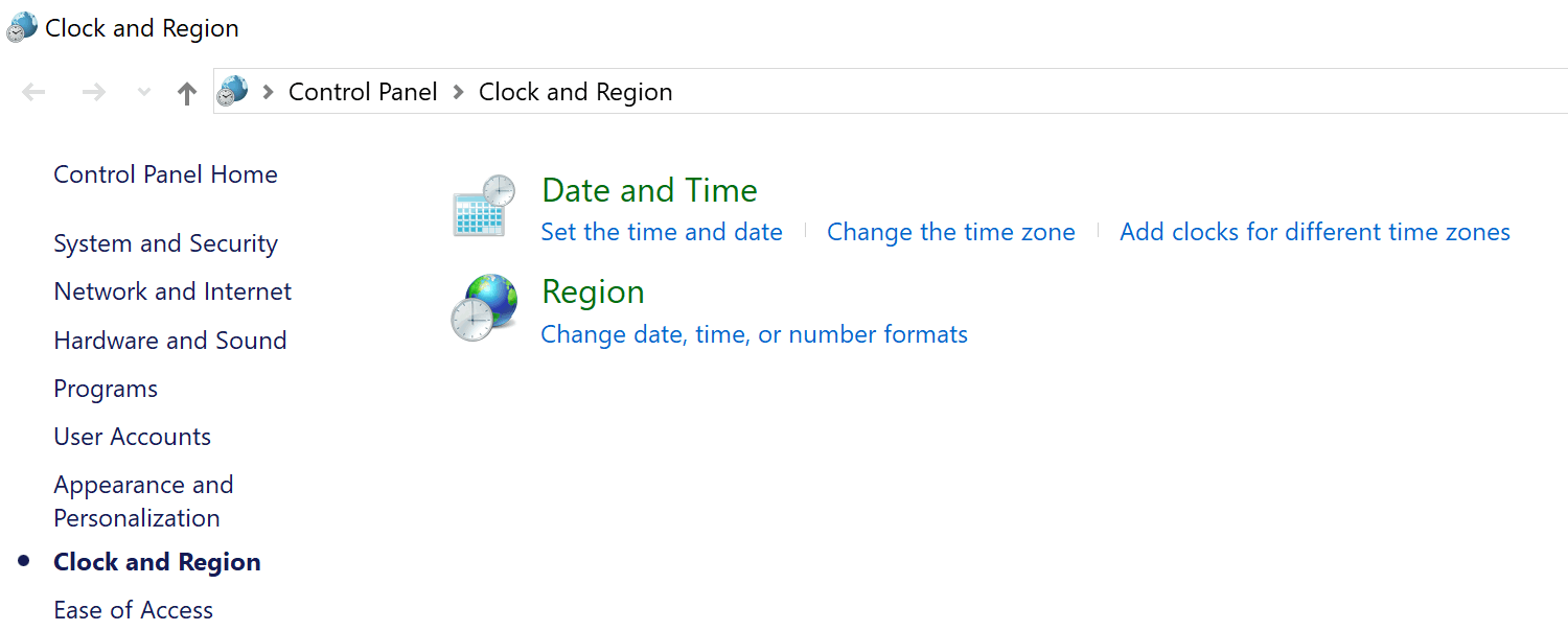

    2024-10-21T03:43:55+00:00
    I had the identical problem with the options greyed out on Windows 10. I stumbled on a different setting dialog where they were enabled and I could change them.
    Go to Control Panel > Clock and Region > Set the Time Zone
