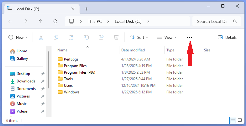

    Without further details, I can only guess at how the "Apply to Folders" procedure is not working for you. It could be that your new default view works in Explorer, but not in file open/save dialog views, or it could be that it doesn't work for special views such as libraries or search results, or it could be that the new default is not even applying to folders of the same type as viewed in Explorer.
    Without going into all the details, you should be able to resolve most of those issues by first clearing out all saved views in the registry before doing the "Apply to Folders" procedure. You can do that by following the procedure here:
    https://www.elevenforum.com/t/reset-folder-view-settings-to-default-in-windows-11-file-explorer.1279/
    Or you can use my free WinSetView tool. It will deal with all of those issues. In the end, it only clears and sets registry values (i.e. nothing is "installed") so there's no downside to using the tool.

    Unless you're using a tool from Microsoft, or a large company that can pay big bucks for an EV certificate, you will see a warning with most tools that you download. That's normal and covered in the documentation. WinSetView is used by thousands of users, it's code-signed, safe, and tested and cleared with Windows Defender. Other AV software sometimes have additional protection options that can interfere with legitimate tools. In such cases, typically all you have to do is adjust a setting. For example, in BitDefender, you may have to turn off "Advanced threat detection" to use many utilities. McAfee probably has something similar. BTW, most computer experts will recommend not using McAfee.
    I will try the procedure you refer to below. Not certain that I can give you accurate feedback as to whether "it worked" because the folders for a while seem to be behaving as I wish (List View) and then seemingly for no reason all revert to Details View. Because the "apply to all folders" option does not work, I have to open every folder and reset. Ouch!
    After having reset all views using that batch file, "Apply to folders" should work, but keep in mind that it's based on folder TYPE and there is no "all" in that button. So, if you are in a folder of type "General items" and select "Apply to folders", it applies that view only to other folders of type "General items". The procedure must be repeated for folders of other types, such as ""Documents" or "Pictures". Windows sets the folder type automatically based on the majority contents of the folder. Therefore a folder's type can change if its content changes. Also note that "Apply to folders" does not update the view you see in an application via a file open/save dialog.
    WinSetView is designed to take the pain out of all those different views for different folder types and dialog views so you can set your preferred defaults once and for all, but if you can't, or won't, use it then you're stuck with the limitations of "Apply to folders". I'd recommend trying WinSetView again and, if it were me, I'd ditch McAfee.
