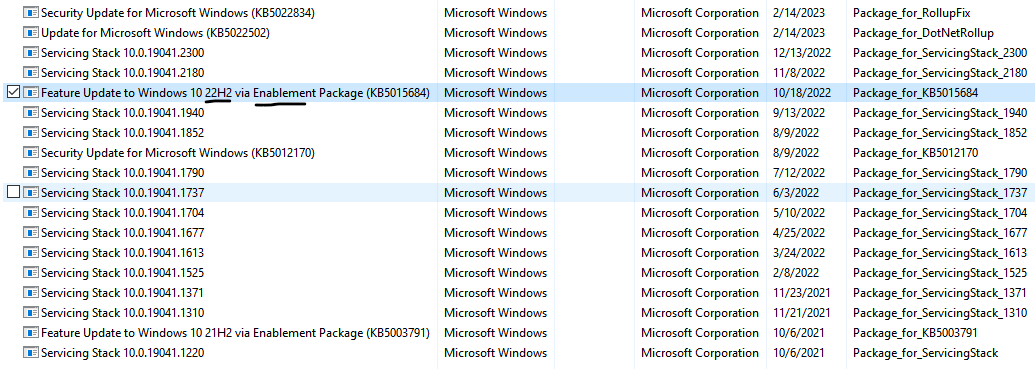

  2. Ramesh 181.8K Reputation points Volunteer Moderator
    2023-02-26T05:57:02+00:00
    a) Yeah, the file size should be the same for every index in the ISO. I checked indexes 1 & 6.
    b) 02/23/2023 is when I ran reagentc /disable and then reagentc /enable. Maybe it's reflecting that date.
