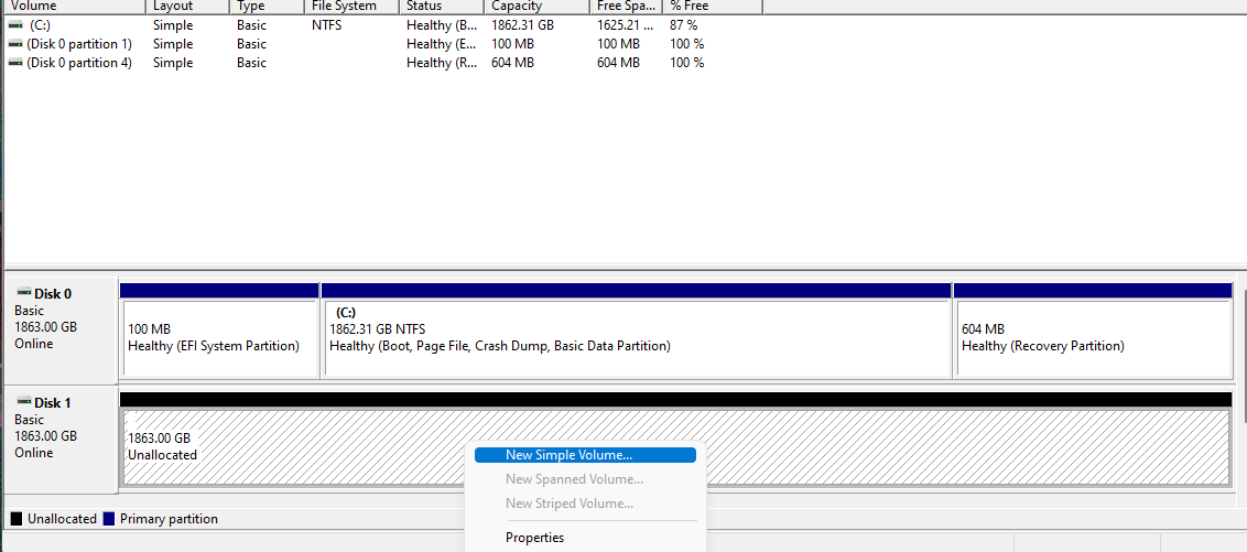

    Although, when i am trying to make a new simple volume on the second drive, its not doing anything:
    2023-02-19T23:35:13+00:00
    You may want to start with the easy way and just delete the volume/space. The options you show seem to be missing some things, perhaps you just cut them out.
    Are you familiar with Diskpart and how it works?
    You could try cleaning the drive again and starting over. Since you have two of the same drives, be very careful which one you select for the operation.

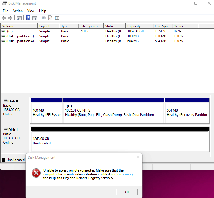

    Also, for some reason, when i click properties on either hard drive, its treating me as if i am accessing a remote computer:
    2023-02-20T03:03:38+00:00
    You should be able to access it via Diskpart. Use an Admin command prompt and type Diskpart, then the commands below. The dis number will be the one showing for the bad drive in the List disk command. Make very sure you have selected the correct one. Using the lis par command would verify what partitions are on that drive.
