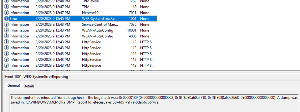

I am trying to update windows to 22h2 in an attempt to troubleshoot another issue i am having (games crashing when booting up dx12 with shaders with "out of video memory" error, same games work on dx11 though) and i have tried multiple times to update to 22h2 but it continuously fails. Windows will download the update, restart, install the update up to 25% and crash with blue screen showing an error with NTFS.sys i believe. So maybe the drive is corrupted by i've do so much to try to fix that.

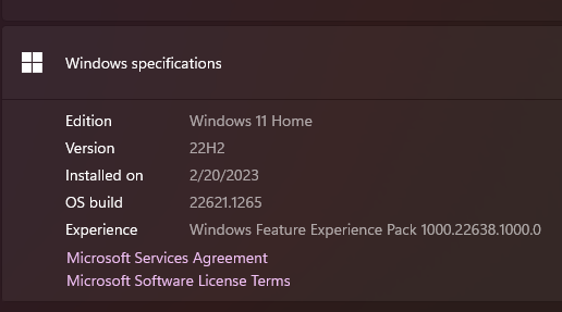

    when it is about finished installing, right at the end, i get the page fault non page area issue and the computer resets and brings me to the windows setup where it just ask me basic personal questions. Typically, this is where i would have issues installing the windows updates multiple times, but the last few times, i have had no issue getting the latest updates it seems up to 22H2 version. Everything seems to work fine.

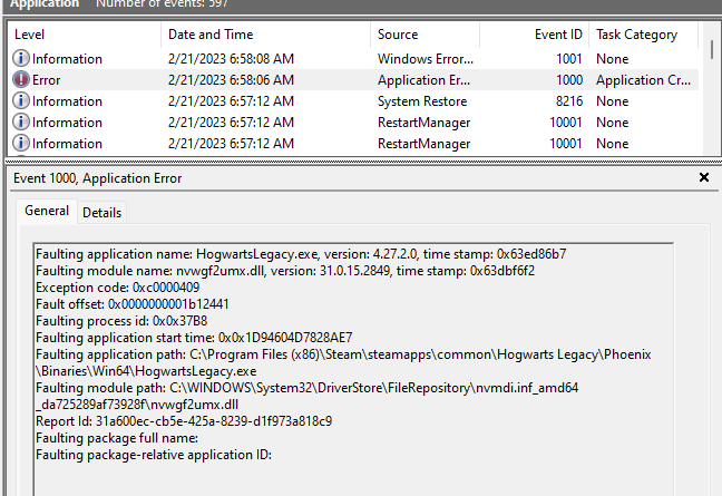

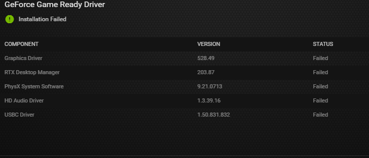

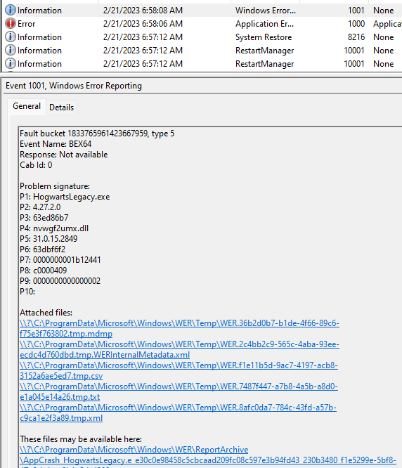

    I do the sfc scannow and other dism commands to make sure everything is fine. typically, i would have some errors, however, the most recent installs have been fine. no errors. But like always, i still have the issue with my geforce drivers failing initially. its like they have to be reinstalled multiple times before it works. Eventually, it installs and i try to play games like hogwarts/callisto/etc. anything that has dx12 and preloads the shaders just instantly crash with the "Out of video memory" error.
    Both my 4090 gpu and 3090 gpu have this same error on this particular system. both cards have been tested on my windows 10 computer with a 9900k processor and work fine. so its not the GPUs and i dont think its the driver from nvidia because that same driver is on my windows 10 build.
