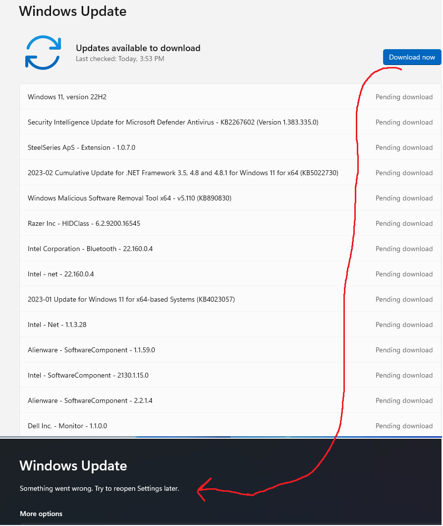

Failed to install version 22h2 0xc190011f
2023-02-18T22:00:57+00:00
I am trying to update windows to 22h2 in an attempt to troubleshoot another issue i am having (games crashing when booting up dx12 with shaders with "out of video memory" error, same games work on dx11 though) and i have tried multiple times to update to 22h2 but it continuously fails. Windows will download the update, restart, install the update up to 25% and crash with blue screen showing an error with NTFS.sys i believe. So maybe the drive is corrupted by i've do so much to try to fix that.

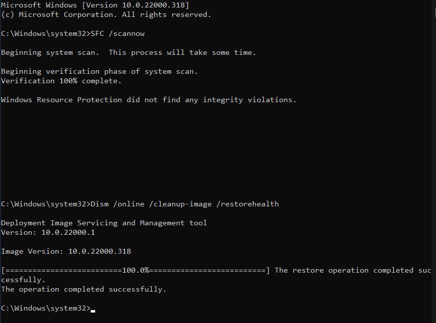

i have tried to the SFC scannow steps, chkdsk /f c:,

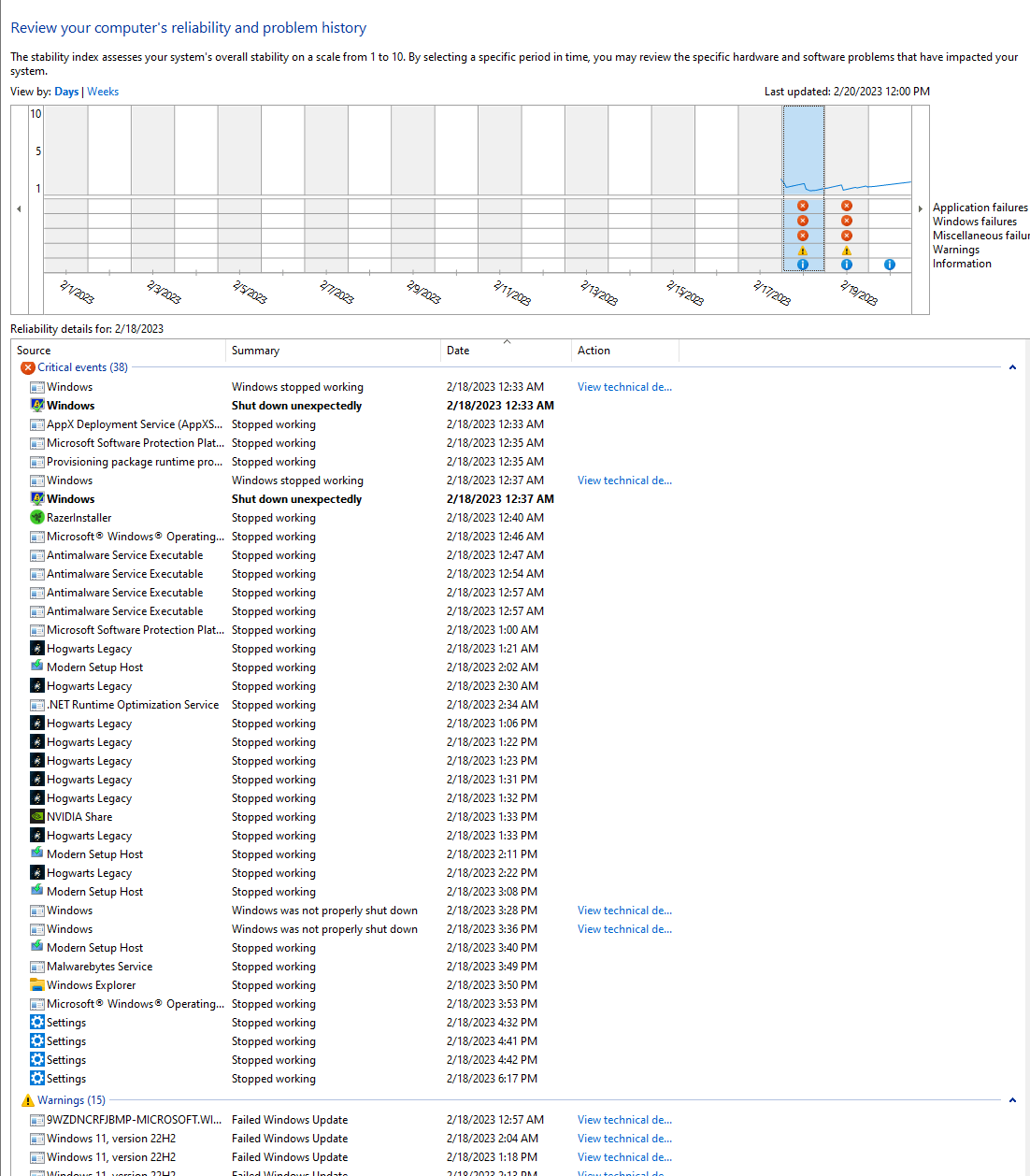

I am inserting some screenshots below if they can possibly help at all:

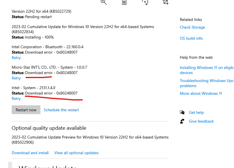

    So first, i made a win 10 media creation tool usb drive, installed windows 10 on the new motherboard and my second m.2 drive. I did not have it connected to the internet this time for the installation since the mobo needs drivers from a usb to get wifi/etc. Once windows was done installing, i installed the drivers for wifi, and started windows updates/mobo updates, however, i was still getting corrupted file issues when i do sfc /scannow. i was also getting errors trying to download some updates.
    I was able to eventually get the corrupted files sorted out with the cmd line DISM/etc. and then i was able to install the windows updates fully. So far everything seems fine.

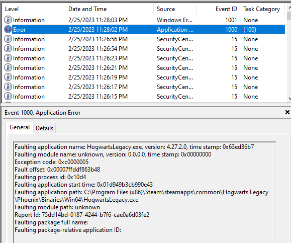

    I then install steam and install callisto, deadspace and hogwarts, all games that was crashing before with the "out of video memory" issue. Surprisingly, callisto and deadspace booted up fully, albeit, with very low frame rate since its just the igpu. When i booted up hogwarts, it did not boot ALL the way, however, it actually got really close to loading all the shaders, about 70% opposed to my 3% and crash i would get with the nvidia graphics card.
    So i try opening hogwarts again, the game just ends up crashing sooner and sometimes doesn't even open. I believe this is just because the game is extremely resource hungry and it just crashes in general, not being of video memory. i dont get the same video memory error when it crashes on the igpu.

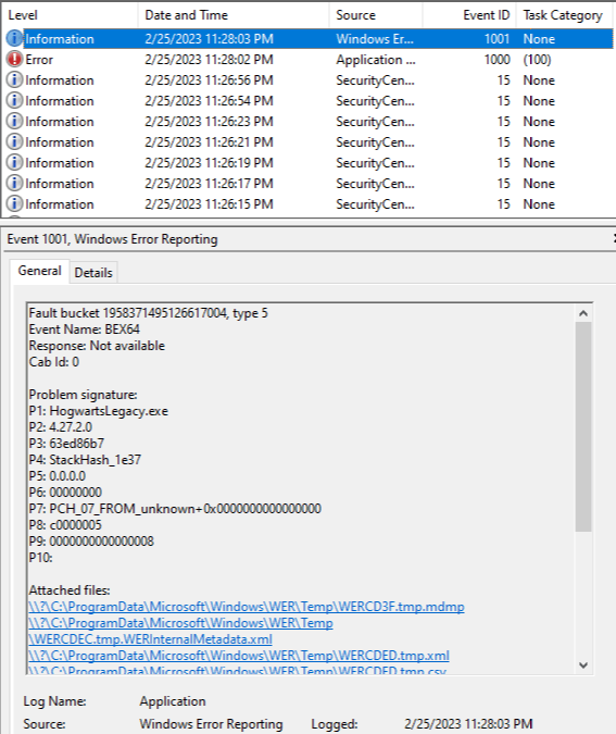

    Here is event viewer showing the crash details under the igpu:
    So since the computer seems to be stable for the most part, i try something slightly different. instead of hooking up my 4090 and installing those drivers, i connected my older gtx 1080ti and installed those drivers. I start the games and yep, i still get the same "out of video memory error".
    So i am very confused to why this video error keeps happening. i have tried 3 separate graphics cards since this has started, 1080ti 11gb vram, 3090 24gb vram, 4090 24gb vram, brand new ram, 2 separate m.2 drives, an entirely new motherboard.

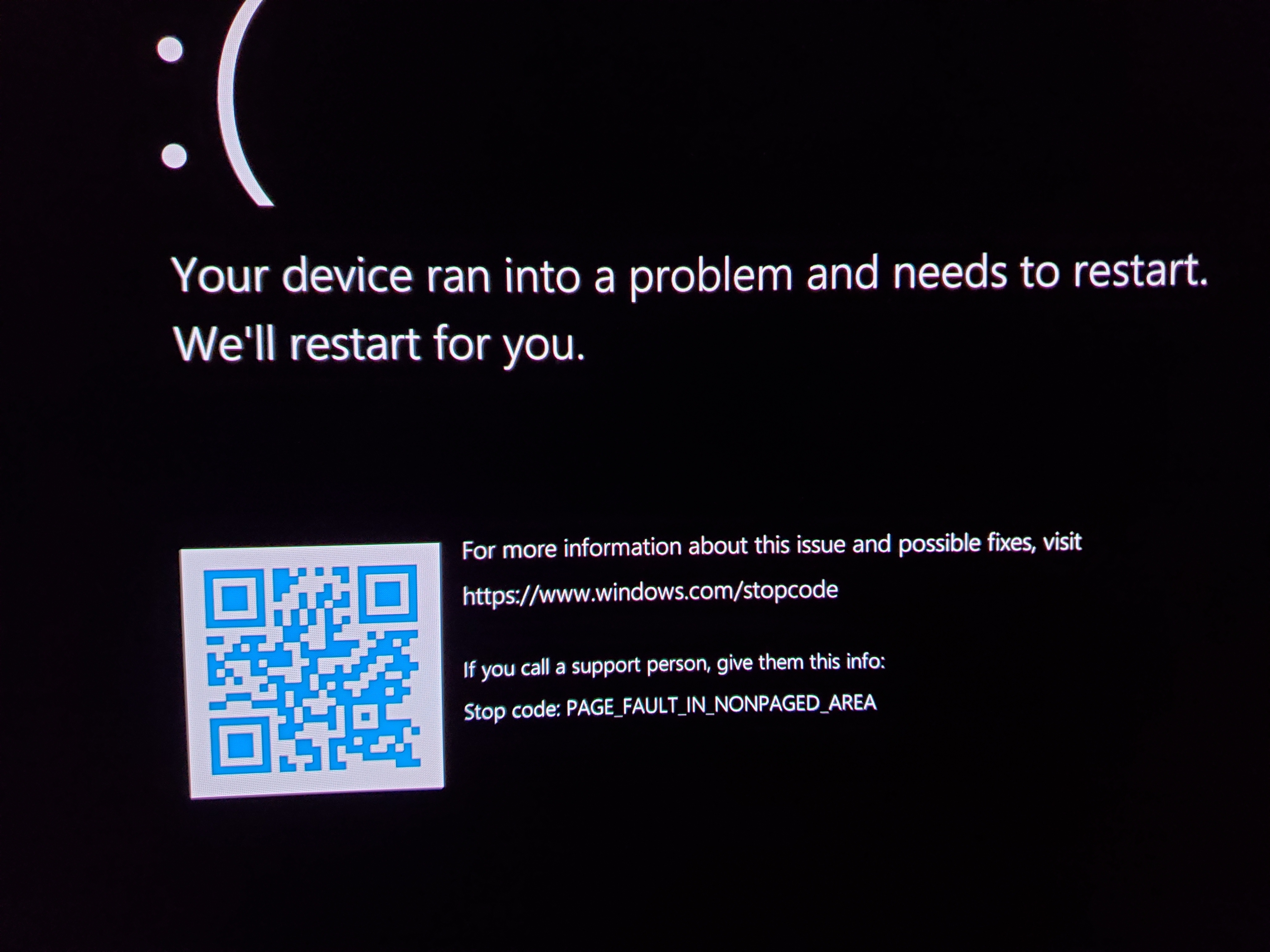

    as i was typing this, the computer is running idle and out of nowhere just blue screens with the oh so familiar error "Page_Fault_In_nonpaged_area" code...
    i can try some more testing but man....i feel so defeated. can do more testing over the weekend but i never had a pc issue as stressful as this.

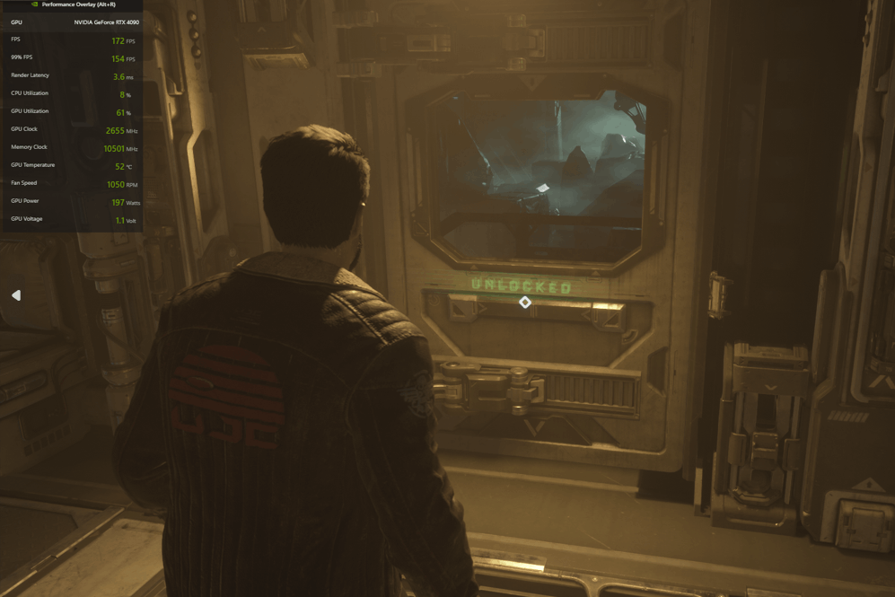

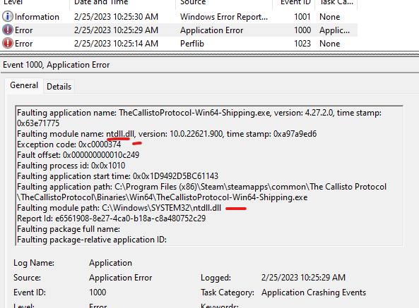

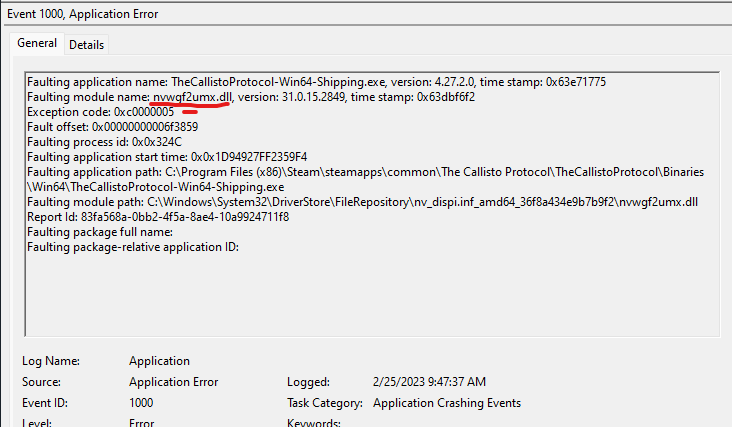

    i am adding some screenshots here of crashes trying to play callisto and also screenshot of callisto working on dx11.
    First, here is a screenshot of callisto protocol working on dx11, not dx12:

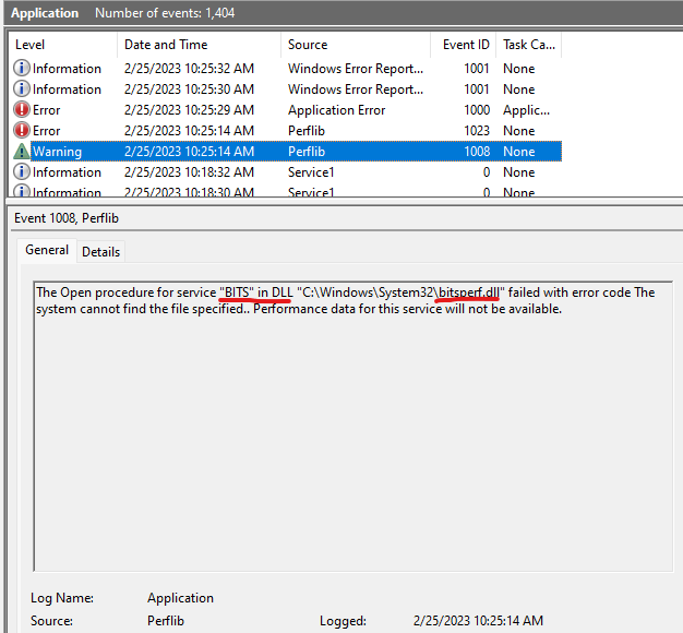

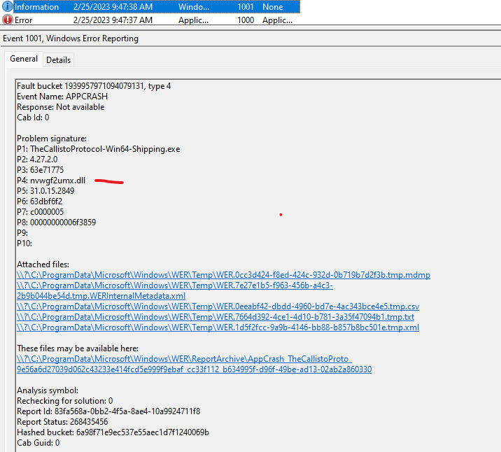

    Here are some event viewer details from it crashing when using dx12. You will see things like nvwgf2umx.dll, bitsperf, perflib, sysmain.dll, etc. i looked all that stuff up and tried fixes for it. seems like its indicated that something is missing for the .dll area? Not sure, but i tried the fixes, did not resolve the issue:
