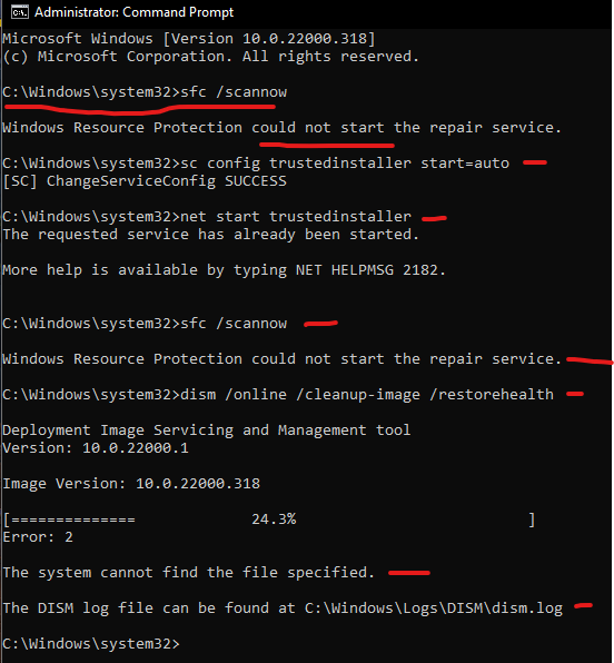

i have tried to the SFC scannow steps, chkdsk /f c:,

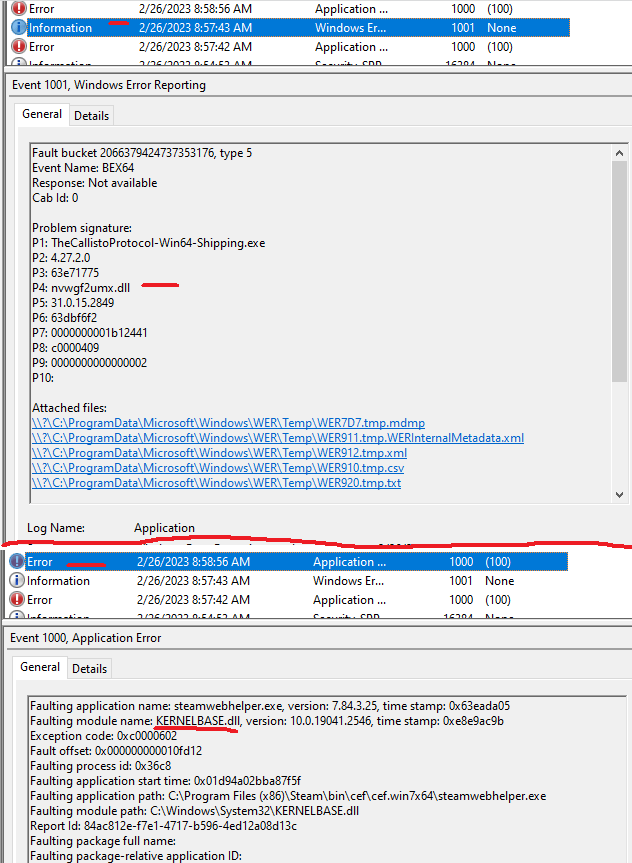

I am inserting some screenshots below if they can possibly help at all:

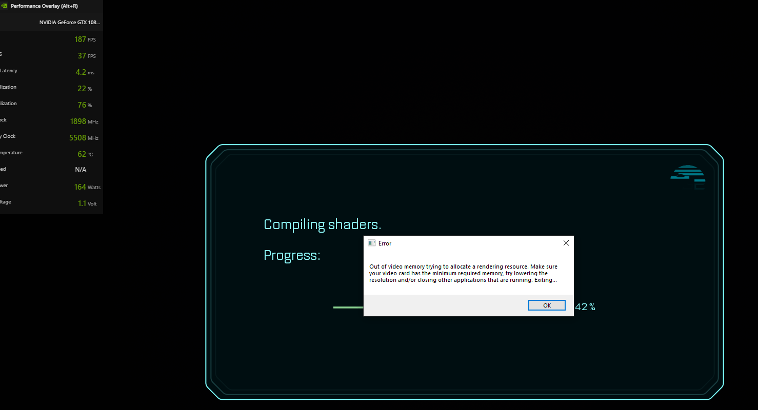

    well i just installed the i5 13600k processor and the new m.2 drive at the same time. so far, i am able to preload callisto protocol with no issues. no video memory leak, using the 1080ti. now i need to put the 4090 in there to see what happens.
    if everything is good after that, then i need to figure out if it was a drive corruption on the 980 2tb drives or if the 13900k was the issue. so after the 4090 gpu test, if all is good, im going to swap the m.2 drives and keep the i5 in there to see what happens.
    *update 1*
    callisto loaded up just fine on the 1080ti and the 4090.
    i am installing dead space and hogwarts to see if they load up on the i5. if everything works right, im going to swap the drives and what happens. all for the sake of troubleshooting, hopefully this doesnt mess up the i5 processor somehow.
    *update 2*
    alright so hogwarts works on the new drive and i5 processor. i swapped back to the 2tb drive and callisto worked just fine but hogwarts has the same video error message and dead space wont boot up at all. very strange.

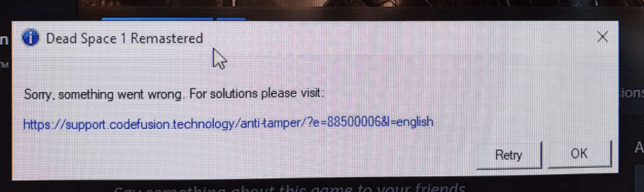

    So i tried the i9 with the new m.2 drive. I started with hogwarts and the game loaded fine. After that, i tried deadspace but received a new error:
    I believe this error is a denuvo error that is not related to my issues and instead, is an issue from denuvo stopping me from playing the game temporarily because of the many times i loaded it up on different hardware. this happened on callisto as well and also on my 9900k system, so its not something i am worried about yet... However, i then for the hell of it, tried hogwarts again, and it had the video error show up again.... Which doesn't make much sense because a few minutes earlier, it loaded the game just fine.

    I have tried in 4k, 1440p, 1080p, 720p.
    I have tried the custom virtual memory size multiple times but also, i just tried it again after you sent the link and reset the computer, same issue:
    Hogwarts does seem to have a known issue with memory leaks and out of video memory issues, however, my issue is not limited to hogwarts, its with any game that has dx12 and preloaded shaders.
    I have tried the other games without starting hogwarts, same issue. i have reset the computer and tried only callisto. tried only deadspace, same errors.
